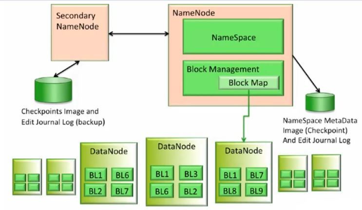

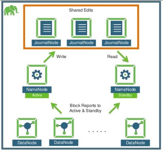

I have attached 2 visuals to help you understand
HTH
