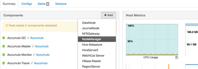

New Member
@Aditya Sirna
Thanks for your quick response.
But the node managers are all up and running
Please find attached the screenshotsscreen-shot-2017-11-23-at-84336-pm.pngscreen-shot-2017-11-23-at-84200-pm.png
Thanks,
Nirmal J
