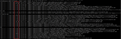

however new error occours, the rpm package's size turns out to be much smaller than it should be.
