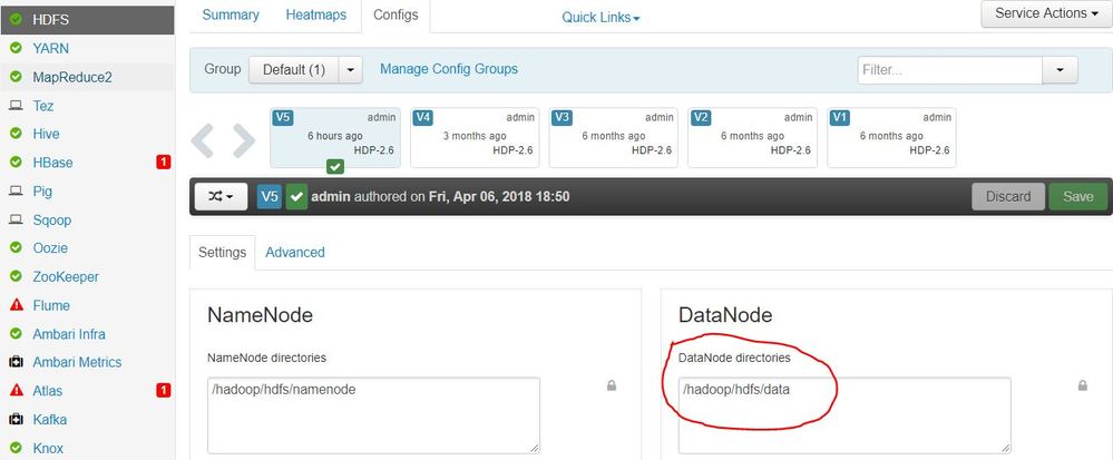

@Siddharth Mishra
This typically indicates a missing filesystem.
[Alert][datanode_unmounted_data_dir] Failed with result CRITICAL: ['The following data dir(s) were not found: /hadoop/hdfs/data\n']
Can you check that the above mount point exists !!! see attached screenshot FS.jpg
Note: The mount points for DataNode and NameNode
if the above File system is NOT mounted update it save and retry.
Please revert
