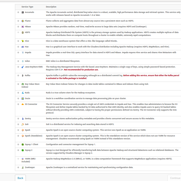

@mbigelow  I have tried to add but there is no option in clouder-manager UI to add anything called 'Spark2' . It has 'Spark' and 'Spark(Standalone)' only. PFA screenshot.

Ok, this means that the CSD file isn't in place and/or Cloudera Manager server was not restarted after it was put in place. Please check both. After the CM server restart the service should be available to add to an existing or new cluster.

@mbigelow Thank you, that solved the issue.
The /opt/cloudera/csd dir was empty, I downloaded CSD and configured it and then re-added service. The above exception is resolved.
