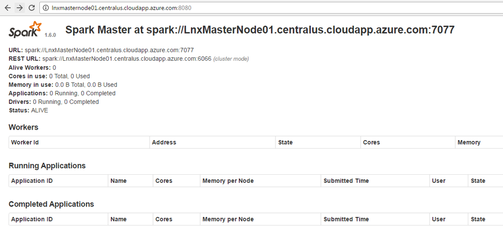

However just one question, in my spark directory (basically spark/sbin) I can see various Stop, Start scripts for Spark Master, slave, history server etc. I tried to start Spark master from the command and now the UI is opening. Do you think I did the right thing? Or it is NOT required? But if I run start slave script, worker UI is Not opening.

Yes, previously(without starting master from the script) i was able to work on spark-shell but not open the master UI. However after I started master through script, I was able to open it.
But as you said we dont need to do it as we need it in standalone spark mode. I would shut it down. What do you say?

Yeah, shut it down.
