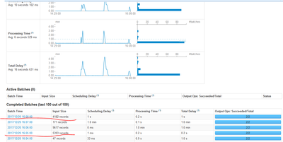

I am running the spark streaming job every minutes, and able get job info like Batch Time,Input Size,Scheduling Delay,Processing Time,Total Delay from below spark streaming link.
http://hostName:8088/proxy/application_1510017956315_42239/streaming/
Below is the spark streaming image :
I need to write each stream info into NOSQL/Database ( Batch Time,Input Size,Scheduling Delay,Processing Time,Total Delay ). I need to read spark streaming log information from unix , so that i can write into NoSQL OR other database.
Please suggest, how to read the log info from unix.

Hi @Saravanan Nagarajan,
you can get the all the above metrics form a REST API and once you got the content you can process them and store in SQL/NOSQL or File based store.
the end point for the REST call would be http://<host>:4040/api/v1/applications/[app-id]/streaming/statistics
this API provides the information about : Statistics for the streaming context ( in fact you can keep this process inside the running job by querying the same context)
more on this REST calls can be found here
Hope this helps !!
