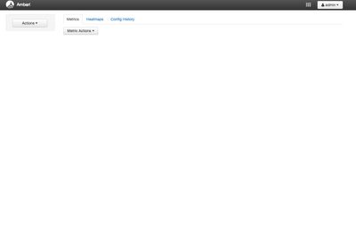

Now when log into ambari i see this:

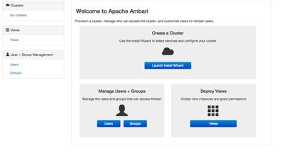

I click on launch install wizard and it takes me to home page of ambari:
Clearly none of the services got installed and it won't let me start over. it is very confused. I called the rest service to determine what cluster it thinks i have running:

If nothing installed to the cluster you can do an ambari-server reset and start over effectively.
1. Stop Ambari Server
ambari-server stop
2. Reset Ambari Server
ambari-server reset
3. Start Start Ambari server
ambari-server start
I would verify that nothing got deployed to any of the hosts in the cluster prior to re-installing.

Even if something did get deployed, you can reset and rerun the install. Once nodes register with ambari server, Ambari will report that it found binaries for hadoop and advise to run cleanup script. Additionally you could yum erase anything hdp.
@Sunile Manjee
We ran into a similar issue with a customer. To clean up you need to do the followin
Stop all services and run the cleanup script
https://cwiki.apache.org/confluence/display/AMBARI/Host+Cleanup+for+Ambari+and+Stack
python /usr/lib/python2.6/site-packages/ambari_agent/HostCleanup.py You have elected to remove all users as well. If it is not intended then use option --skip "users". Do you want to continue [y/n] (n)
Run the above on each hosts.
Next you would want to do a ambari reset and follow the steps that Scott mentioned.
