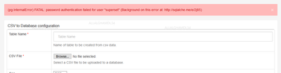

While trying to upload a csv file to Superset using the GUI I get the following
(pg.InternalError) FATAL: password authentication failed for user "superset" (Background on this error at: http://sqlalche.me/e/2j85)
You can check the photo attached.

Have the same problem.
In my case the "problem" was caused by authentication method.
To "resolve" in my test environment I set authentication method from md5 into trust in pg_hba.conf in my Postgresql server on the database used for importing data.
Another authentication methods caused the same error.
I believe this is something like bug...

You can simply fix this problem https://github.com/apache/incubator-superset/issues/4285
So, change lines in file: /usr/hdp/current/superset/lib/python3.4/site-packages/superset/db_engine_specs.py
to follow:
line 137: 'con': create_engine(form.con.data.sqlalchemy_uri_decrypted, echo=False),
line 882: engine = create_engine(form.con.data.sqlalchemy_uri_decrypted)
