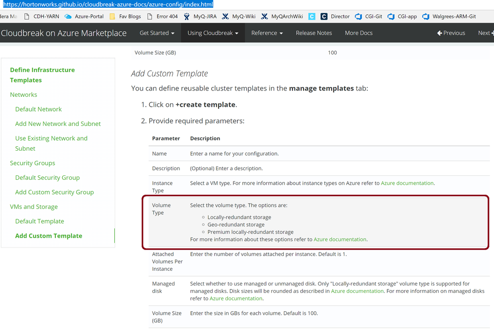

I am trying to create a custom template and pick premium managed disks for masters and standard managed disks for workers.
The documentation details the option of selecting "Volume Type" for making such a distinction.
https://hortonworks.github.io/cloudbreak-azure-docs/azure-config/index.html under "Custom template".

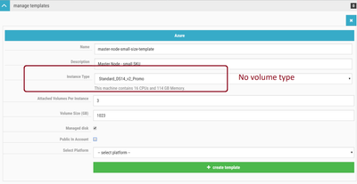

However, in my Cloudbreak GUI, I dont see the "Volume type" dropdown.
What am I missing here?

@Anagha Khanolkar
Good observation, at the point of the early adopter implementation, only Standard LRS storage was supported for managed disks, Premium LRS was introduced since then, so "Volume type" is hidden from the UI and going with .
Premium managed disks will be supported in the near future version of Cloudbreak. Would you like to use Premium LRS?
Hope this helps!
