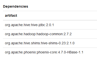

Everything worked except the dependencies of the JDBC interpreter. I am getting the following error: Error setting properties for interpreter 'jdbc.jdbc': Cannot fetch dependencies for org.apache.hive:hive-jdbc:2.0.1

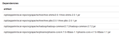

If I confirm that there no Internet connection, how could I resolve the dependencies? Download them manually and then as local dependencies?

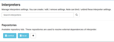

If I have Internet, how could I test the Maven connectivity from Zeppelin and also change it?
I already set some local file dependencies but doing so for future scenarios is not the dream of a developer (see file attached)
I also found the interpreters repositories but I don't know how to see their properties with the user interface (I found them in a json file in the conf directory)
