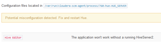

  • In the HUE main page
It's shown
Potential misconfiguration detected. Fix and restart Hue.
Hive Editor    The application won't work without a running HiveServer2.

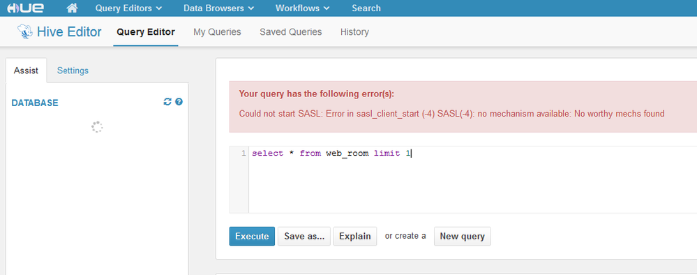

  • In HiveEditor page
the database list could not be shown(always loading...)
I executed a simple sql and got an error "Could not start SASL: Error in sasl_client_start......."
