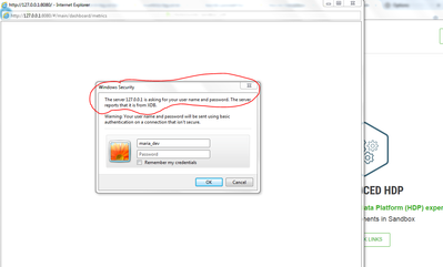

I am able to log on on the console and I was able to reset the password, still on the browser, I am getting an error. The issue I suspect is on the port. Is there a way of deleting the port 8080 on my pc if its already running, that way I can do a clean install of the sandbox.
Does the XDB looks familiar? I But even after I removed the sandbox completely, if I access the ip address and the port 8080, I get the same log on page and I cant still log on, so I dont think its a sandbox issue, but maybe its the port number which is messing up..

Master Mentor
@Paul Bere
Ambari uses It's own custom Form Authentication. But your screen shows a Browser (Basic Auth Window).
Also the XDB (Which i guess oracle tomcat instance uses) suggests that you might be running Oracle On your Local machine ... it also uses port 8080. The password prompt is coming from there. Please stop any oracle instance on your local machine and then try accessing ambari again.
New Member
@Jay SenSharma You are correct. It was an Oracle database which was using the same port. I uninstalled the database and it worked. Thanks so much for the help. I am now all logged on!!
