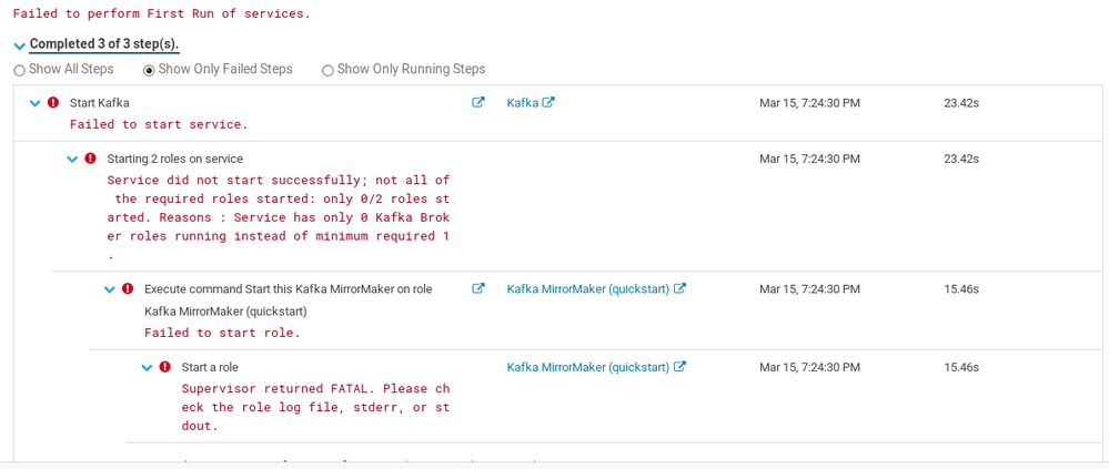

Process followed steps:
1. Activated CDH5 and kafka parcel from Hosts -> Packets
2 .Ran below commands
$ sudo yum clean all
$ sudo yum install kafka
$ sudo yum install kafka-server
3. Added Kafka service from Cloudera Quickstart.
4. Started service, kafka broker is started but kafka mirror maker is not started
Error log:
Supervisor returned FATAL. Please check the role log file, stderr, or stdout.
Kafka MirrorMaker (quickstart)
Mar 16, 8:35:17 AM 15.39s
$> csd/csd.sh ["start"]
abort.on.send.failure: true
offset.commit.interval.ms: 60000
consumer.rebalance.listener:
consumer.rebalance.listener.args:
message.handler:
message.handler.args:
SOURCE_SECURITY_PROTOCOL: PLAINTEXT
DESTINATION_SECURITY_PROTOCOL: PLAINTEXT
KAFKA_MIRROR_MAKER_PRINCIPAL:
SOURCE_SSL_CLIENT_AUTH: false
DESTINATION_SSL_CLIENT_AUTH: false
Kafka version found: 0.11.0-kafka3.0.0
Fri Mar 16 08:35:29 PDT 2018
JAVA_HOME=/usr/java/jdk1.7.0_67-cloudera
Using -XX:+HeapDumpOnOutOfMemoryError -XX:HeapDumpPath=/tmp/kafka_kafka-KAFKA_MIRROR_MAKER-6f7e9fa2e076f5332a81ffe11109ab36_pid23448.hprof -XX:OnOutOfMemoryError=/usr/lib64/cmf/service/common/killparent.sh as CSD_JAVA_OPTS
Using /var/run/cloudera-scm-agent/process/125-kafka-KAFKA_MIRROR_MAKER as conf dir
Using scripts/mirrormaker_control.sh as process script
CONF_DIR=/var/run/cloudera-scm-agent/process/125-kafka-KAFKA_MIRROR_MAKER
CMF_CONF_DIR=/etc/cloudera-scm-agent
Date: Fri Mar 16 08:35:29 PDT 2018
Host: quickstart.cloudera
Pwd: /var/run/cloudera-scm-agent/process/125-kafka-KAFKA_MIRROR_MAKER
CONF_DIR: /var/run/cloudera-scm-agent/process/125-kafka-KAFKA_MIRROR_MAKER
KAFKA_HOME: /opt/cloudera/parcels/KAFKA-3.0.0-1.3.0.0.p0.40/lib/kafka
Zookeeper Quorum: quickstart.cloudera:2181
Zookeeper Chroot:
no.data.loss: true
whitelist:
blacklist:
num.producers: 1
num.streams: 1
queue.size: 10000
queue.byte.size: 100000000
JMX_PORT: 9394
MM_HEAP_SIZE: 256
MM_JAVA_OPTS: -server -XX:+UseParNewGC -XX:+UseConcMarkSweepGC -XX:+CMSClassUnloadingEnabled -XX:+CMSScavengeBeforeRemark -XX:+DisableExplicitGC -Djava.awt.headless=true
message.handler:
Role log:
7:41:33.111 PM INFO MirrorMaker$
Starting mirror maker
7:41:33.181 PM ERROR MirrorMaker$
whitelist must be specified when using new consumer in mirror maker.
STRERR Log:
++ pwd
+ export LOG_DIR=/var/run/cloudera-scm-agent/process/125-kafka-KAFKA_MIRROR_MAKER
+ LOG_DIR=/var/run/cloudera-scm-agent/process/125-kafka-KAFKA_MIRROR_MAKER
+ '[' -z '' ']'
+ export KAFKA_HEAP_OPTS=-Xmx256M
+ KAFKA_HEAP_OPTS=-Xmx256M
+ '[' -z '' ']'
+ export 'KAFKA_JVM_PERFORMANCE_OPTS=-XX:+HeapDumpOnOutOfMemoryError -XX:HeapDumpPath=/tmp/kafka_kafka-KAFKA_MIRROR_MAKER-6f7e9fa2e076f5332a81ffe11109ab36_pid23448.hprof -XX:OnOutOfMemoryError=/usr/lib64/cmf/service/common/killparent.sh -server -XX:+UseParNewGC -XX:+UseConcMarkSweepGC -XX:+CMSClassUnloadingEnabled -XX:+CMSScavengeBeforeRemark -XX:+DisableExplicitGC -Djava.awt.headless=true'
+ KAFKA_JVM_PERFORMANCE_OPTS='-XX:+HeapDumpOnOutOfMemoryError -XX:HeapDumpPath=/tmp/kafka_kafka-KAFKA_MIRROR_MAKER-6f7e9fa2e076f5332a81ffe11109ab36_pid23448.hprof -XX:OnOutOfMemoryError=/usr/lib64/cmf/service/common/killparent.sh -server -XX:+UseParNewGC -XX:+UseConcMarkSweepGC -XX:+CMSClassUnloadingEnabled -XX:+CMSScavengeBeforeRemark -XX:+DisableExplicitGC -Djava.awt.headless=true'
+ [[ 3 < 2 ]]
+ exec /opt/cloudera/parcels/KAFKA-3.0.0-1.3.0.0.p0.40/lib/kafka/bin/kafka-mirror-maker.sh --abort.on.send.failure true --new.consumer --num.streams 1 --offset.commit.interval.ms 60000 --consumer.config /var/run/cloudera-scm-agent/process/125-kafka-KAFKA_MIRROR_MAKER/mirror_maker_consumers.properties --producer.config /var/run/cloudera-scm-agent/process/125-kafka-KAFKA_MIRROR_MAKER/mirror_maker_producers.properties
SLF4J: Class path contains multiple SLF4J bindings.
SLF4J: Found binding in [jar:file:/opt/cloudera/parcels/KAFKA-3.0.0-1.3.0.0.p0.40/lib/kafka/libs/slf4j-log4j12-1.7.25.jar!/org/slf4j/impl/StaticLoggerBinder.class]
SLF4J: Found binding in [jar:file:/opt/cloudera/parcels/KAFKA-3.0.0-1.3.0.0.p0.40/lib/kafka/libs/slf4j-log4j12-1.7.5.jar!/org/slf4j/impl/StaticLoggerBinder.class]
SLF4J: See http://www.slf4j.org/codes.html#multiple_bindings for an explanation.
SLF4J: Actual binding is of type [org.slf4j.impl.Log4jLoggerFactory]

In the Kafka Service add wizard, ensure you enter at least one entry under the presented Mirror Maker pre-configuration page for the field "Topic Whitelist".
You can do this after adding the service (like in your current case) by visiting CM -> Kafka -> Configuration, look for "Topic Whitelist" and add some valid values to it.

Kafka started working.
