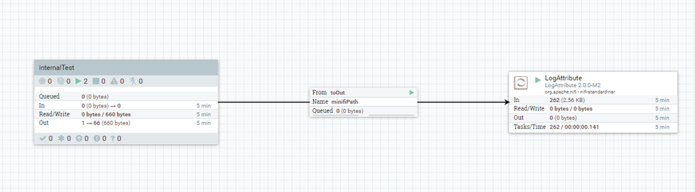

Explorer
@MattWho thank you for responding back, I do understand I did not include the  "nifi-dbcp-service-nar". But this time I am trying to run a new flow which is defined as below
Image 1Image 1
Image 2: This the flow designed inside the  internalTest processGroupImage 2: This the flow designed inside the internalTest processGroup
When I downloaded the flow definition of the internalTest and placed it in the conf folder of minifi I am still facing the same issue.

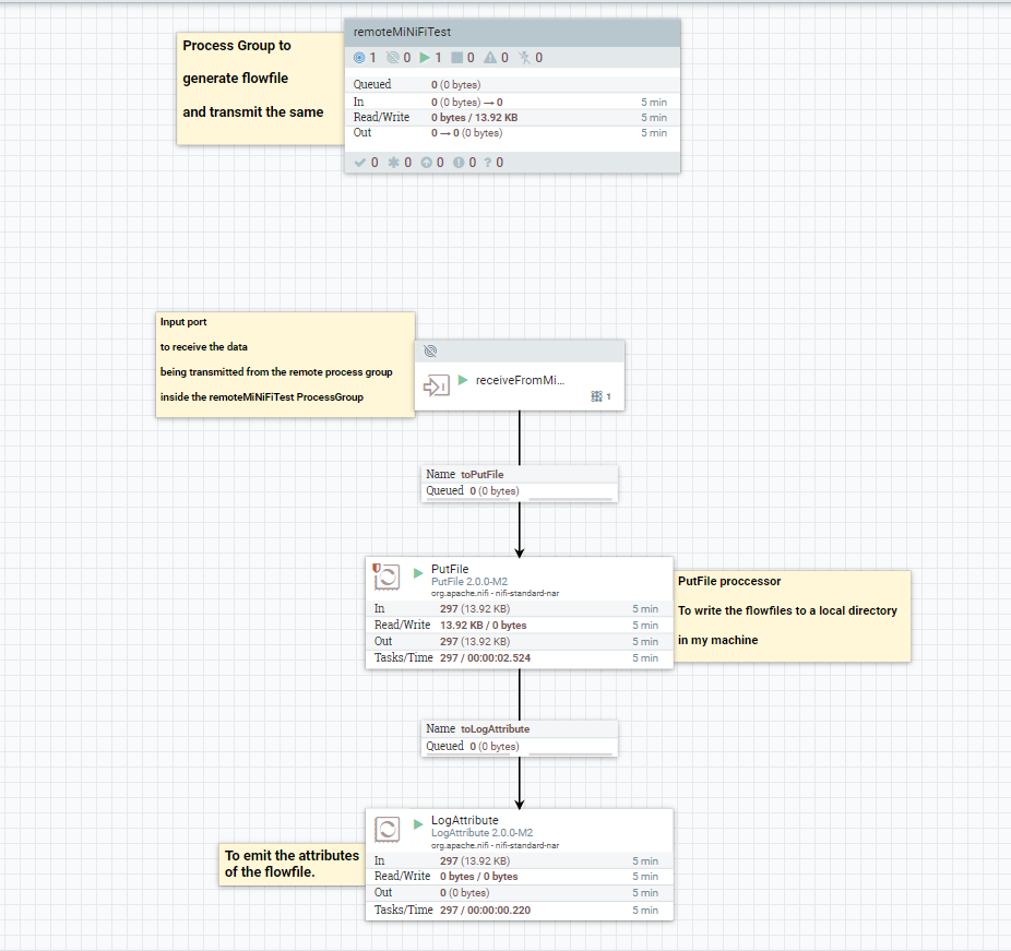

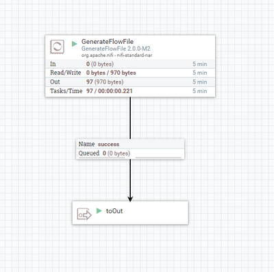

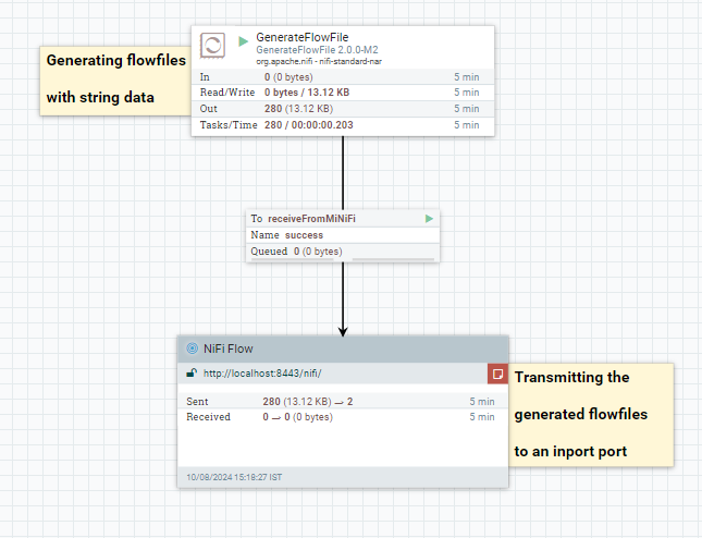

Explorer
Hi @MattWho, once again Thank you as always.
After going through your answer these are things I did.
1) I have created a new flow as attached below
Image 1Image 1
Image 2Image 2
Where Image 1 represents the complete flow and Image 2 shows the flow inside the remoteMiNiFiTest.
2) After designing the flow I have download the flow of the remoteMiNiFiTest as a .json file and converted into flow.json.gz using the minifi toolkit. ( Why I didn't convert it into a flow.json.raw
