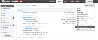

2. You can evenly distribute data across datanodes using Balancer as shown below.
Expert Contributor
@Sagar ShimpiThanks for pointing me to "Rebalance HDFS" utility. After I clicked on Rebalance HDFS, the progress bar quickly ended saying success. Shouldn't this be a long procedure, with lots of data being sent from one node to another to balance?. How do I know when the process will finish, if it has not ended, because after click that link, I do not see any change immediately.
Super Guru
@Pradeep kumar
  1. Browse to namenode UI http://:50070/>:50070/
  2. On the top panel click on "Datanodes"
  3. Check for "Used" and "Non DFS Used" "Used" - This is HDFS used space "Non DFS Used" - This is data stored on local filesystem within the datanode.data.dir directory(hdfs dir path of datanode)
Please check above value. It seems your HDFS data was too less and hence balancer took less time to completed. Please do let me know the ambari and hdp version you are using.
