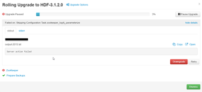

I try run rolling upgrade with subject versions.
And it fails with the very strange message. I added the image with current state
and in ambari-server.log I see this lines:
WARN [Server Action Executor Worker 2015] ServerActionExecutor:471 - Task #2015 failed to complete execution due to thrown exception: java.lang.NullPointerException:null
        at org.apache.ambari.server.serveraction.upgrades.ConfigureAction.execute(ConfigureAction.java:200)
        at org.apache.ambari.server.serveraction.ServerActionExecutor$Worker.execute(ServerActionExecutor.java:550)
        at org.apache.ambari.server.serveraction.ServerActionExecutor$Worker.run(ServerActionExecutor.java:466)
        at java.lang.Thread.run(Thread.java:745)

@Ilya Li
Are you using Ambari 2.6.2 version?
For some reason your source repository is coming as null - you can refer at https://github.com/apache/ambari/blob/release-2.6.2-rc0/ambari-server/src/main/java/org/apache/ambar...
I would recommend you to downgrade and then attempt the upgrade again as upgrade is just started (3% completed)
