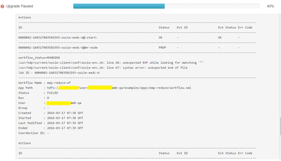

Hi,
I tried upgrading non kerberized HDP 2.3.2 cluster to HDP 2.4.
During the upgrade process the Oozie service check failed.
Did anyone encounter this?
Thanks.

I have modified the statement at line 66 in the file oozie-env.sh
export OOZIE_CLIENT_OPTS="${OOZIE_CLIENT_OPTS} -Doozie.connection.retry.count=2
to
export OOZIE_CLIENT_OPTS="${OOZIE_CLIENT_OPTS} -Doozie.connection.retry.count=2"
We are getting the same error.
What could be the possible value for OOZIE_CLIENTS_OPTS in HDP 2.4?
Thanks.

Can you try to add that final quote through Ambari, not directly in the oozie-env file. The value looks good, at least the "unexpected EOF" error should go away. By the way, in my 2.3.2 version the count is set to 5 instead of 2.

Thanks @Predrag.
It worked when I changed it through Ambari.
