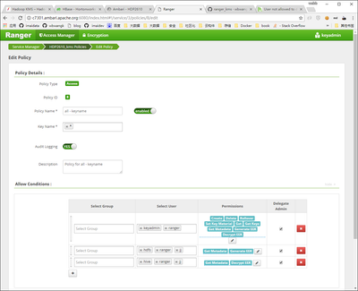

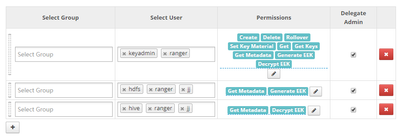

I meet the same problem:
$ hdfs dfs -put ./ca.key /tmp/webb
put: User:jj not allowed to do 'DECRYPT_EEK' on 'zonekey1'
I fix the problem by add permissions to user 'jj'.

I checked the kms-acls.xml file and the value for all the properties is * set. Is there any property I need to change to make it work ?
Re: User not allowed to do 'DECRYPT_EEK' despite the group to which the user belong have proper access
New Contributor
@Geoffrey Shelton Okot
my kms is new installed. I check kms-acls.xml, all conf is default (almost is "*")。 I changed the policy, and it work.
