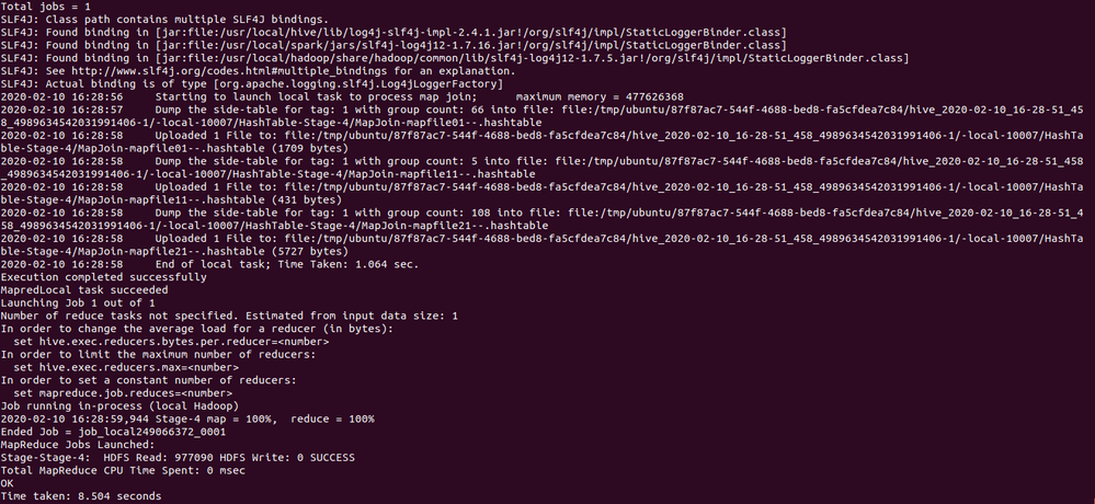

When i run the query it's executed but the output is not display in hive?
Explorer
2020-02-10 16:28:56 Starting to launch local task to process map join; maximum memory = 477626368
SELECT n.Id,
t.job_id,
t.job_title,
n.Name,
n.Email,
n.Mobile_Number,
n.Education,
n.Total_Experiance,
n.project_id,
((count(n.new_skills)*100)/s.skill_count) Average
FROM
rmt_demo.resume_convert n
JOIN
rmt_demo.job_description_convert t ON n.new_skills = t.skills and n.job_position = t.job_title
JOIN
rmt_demo.skill_count s ON n.job_position = s.job_title
JOIN
rmt_demo.education e ON n.education = e.education
GROUP BY
n.Id,t.job_id,t.job_title, n.Name, n.Email, n.Mobile_Number, n.Education, n.Total_Experiance,n.project_id,s.skill_count;

@venkatsambath  We are not using CDH. We have configured Hadoop ecosystem separately in Ubuntu 18.04 (Hadoop 2.6.0, Hive 2.1.1).
When using the select query without using insert line and run the query i am getting same problem in hive.

@venkatsambathevery thing i ok in table but still i am facing the same problem.
I am load my data from local to hive.
