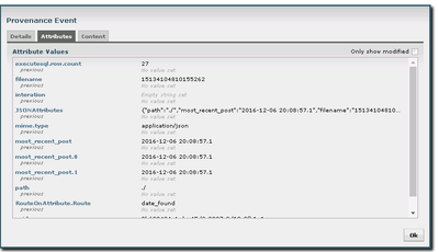

Created on 12-06-2016 09:52 PM - edited 08-19-2019 01:21 AM
Thanks for the prompt reply. I've also tried to address this question in item:
I'm trying to get similar behavior as can be seen below for 'executesql.row.count' by using a user-defined property (property - iteration : value - ${'fragment.index'} <with and without single quote, set prior to 'SplitJson' or set post 'SplitJson')
I'm only able to get 'No value set' or 'Empty value set' no matter what I try.

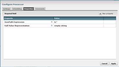

The splitjson is very straight forward and successfully builds many json array objects using the expression below.
All I'm attempting to due is keep track of the queue position, so I can act on the last row to post the last transaction date. The attribute 'queue position' would also be of interest, but it also contains no data.
Thanks,
~Sean

Created 12-06-2016 09:55 PM
Ah, I see we're at NiFi version 0.5.1.1.1.2.1-34, so that explains why I am not seeing these attributes.
