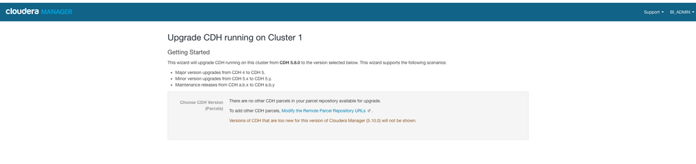

I recently upgraded CM to 5.10.0. Trying to upgrade CDH from the Manager from 5.8.0 throws up the same issue. I cannot see or select the CDH. Attached is a screenshot. Any help in figuring out next steps to get this running will help.
