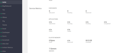

Getting confused when trying to run a YARN process and getting errors. Looking in ambari UI YARN section, seeing...
(note it says 60GB available). Yet, when trying to run an YARN process, getting errors indicating that there are less resources available than is being reported in ambari, see...

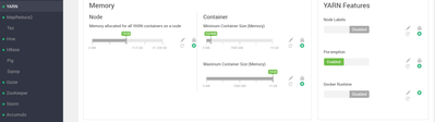

Yet, I have YARN configured with
yarn.scheduler.maximum-allocation-vcores=3yarn.nodemanager.resource.cpu-vcores=3yarn.nodemanager.resource.memory-mb=15GByarn.scheduler.maximum-allocation-mb=15GB
and we can see both container and node resource restrictions are higher than the requested container size.

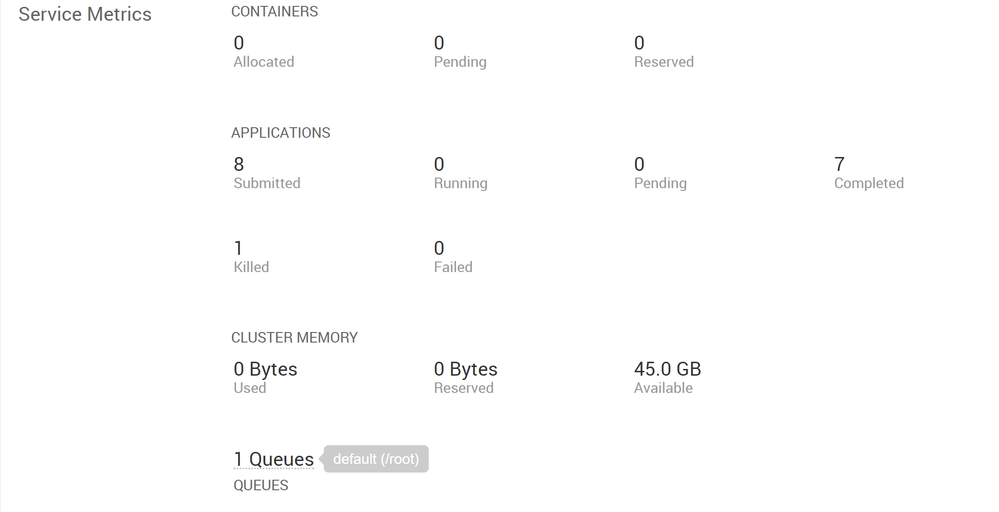

Queue 'default' approximate utilization: 5.0 / 60.0 GB used, 1 / 12 vcores used
I would like to use the full 60GB that YARN can ostensibly provide (or at least have the option to, rather than have errors thrown). Would think that there should be enough resources to have each of the 4 nodes provide 15GB (> requested 4x5GB=20GB) to the process. Am I missing something here? Note that I only have the default root queue setup for YARN?
----- Nodes -----
Node: http://HW03.ucera.local:8042 Rack: /default-rack, RUNNING, 1 containers used, 5.0 / 15.0 GB used, 1 / 3 vcores used
Node: http://HW04.ucera.local:8042 Rack: /default-rack, RUNNING, 0 containers used, 0.0 / 15.0 GB used, 0 / 3 vcores used
Why is only a single node being used before erroring out?
From these two things, it seems that neither the 15GB node limit nor the 60GB cluster limit are being exceeded, so why are these errors being thrown? What about this situation am I misinterpreting here? What can be done to fix (again, would like to be able to use all of the apparent 60GB of YARN resources for the job without error)? Any debugging suggestions of fixes?
