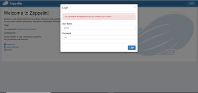

Hi
I'm unable to access my Zeppelin account, do you have any idea where i can find the username and password?
Thank you

Hi,
We can create the Username and password as mentioned in the below doc
 http://zeppelin.apache.org/docs/0.7.0/quickstart/explorezeppelinui.html
or the default id and password is admin/admin
Thanks

@MEFTAH1997 Kindly share the zeppelin logs for the timeframe when login failed.
Also check if you are hitting the same issue as below.
https://community.cloudera.com/t5/Customer/ERROR-quot-org-apache-shiro-authc-AuthenticationException...
Solution:
 To resolve this issue you can try the below steps.
usermod -a -G shadow zeppelin
chgrp shadow /etc/shadow
chmod 040 /etc/shadow
rm -f /var/run/nologin
