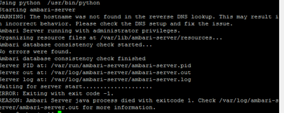

amabri installation on centos failed stating that is process id is stale.?Please help on this guys

Looks like you have not configured the FQDN properly on your ambari host. Please check the /etc/hosts file to verify the hostname is correct and it matches the output of the following command:
# hostname -f
Prerequisite of Ambari Installation : (Set the Hostname😞 http://docs.hortonworks.com/HDPDocuments/Ambari-2.5.0.3/bk_ambari-installation/content/check_dns.htm...
- http://docs.hortonworks.com/HDPDocuments/Ambari-2.5.0.3/bk_ambari-installation/content/edit_the_host...
. Also can you please share the output of the file "/var/log/ambari-sever/ambari-server.out" here so that we can see if there are any additional issues?

@saravanan gopalsamy
Please check your /etc/sysconfig/network file. What is the value of hostname? This should be fully qualified domain name. Then compare it with /etc/host file.
Ambari is not able to resolve reverse DNS. What is the value of your hostname in
It should be your fully qualified domain name. Is this what your /etc/host is also pointing to?
Thankyou @mqureshi the /etc/hosts file was not updated properly
