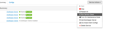

but script print INFO FAIL on zookeeper in spite from ambari GUI zookeeper servoce check completely successfully - why?
from ambari GUI service check on zookeeper is working fine
