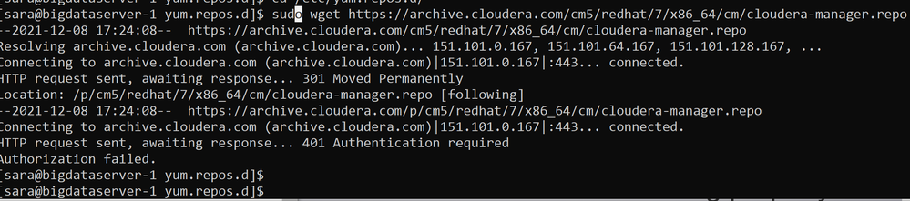

I can't download cloudera manager
I used this link in ubuntu :sudo wget https://archive.cloudera.com/cm5/redhat/7/x86_64/cm/cloudera-manager.repo
Can anyone help !

Hi @Saraali
Hopefully you are aware that earlier this year, Cloudera modified its repositories and as such the binaries for Cloudera Manager are now only available in a private repository. If not, please see the announcement here: Transition to private repositories for CDH, HDP and HDF.
You didn't supply the required authentication credentials when you submitted the wget command, and that is why you received an HTTP 401 error in response. Downloading the Cloudera Manager binaries requires first having an active subscription agreement in place and obtaining a license key file along with the required authentication credentials. The credentials to access this private repository are not generally the same ones to access Cloudera's website or the Cloudera community.
That same announcement also has information on how to go about obtaining a subscription agreement and the required authentication credentials for the private repository if you don't already have them. If you're just looking to evaluate a data platform, you can currently do so without an existing valid Cloudera subscription by downloading and installing the Trial Version of CDP Private Cloud Base Edition of Cloudera Data Platform on Ubuntu.

@Saraali
You need to provide the credentials to get access to the repository. You can follow the documentation [1]  for the whole process to install CM-server, agents.
To access the binaries at the locations below, you must first have an active subscription agreement and obtain a license key file along with the required authentication credentials (username and password).
