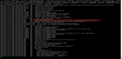

Thanks for your reply, I did not enable tls. The following is the error log of /var/log/cloudera-scm-agent/cloudera-scm-agent.log. This is my first attempt to deploy this, and I hope to get your help

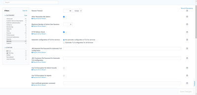

I think is getting an SSL from somewhere. Can you go to CM UI >> Administration >> Settings >> Click on Security and check if TLS is enforced on the agent from CM UI

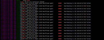

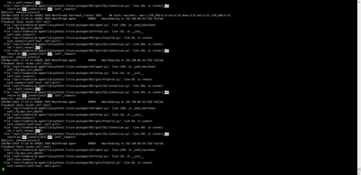

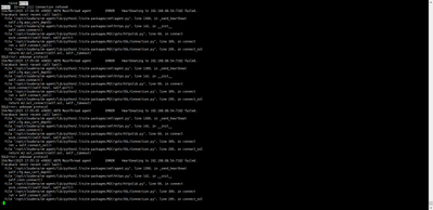

c) Except for the error information in the following pictures, other logs do not contain error information

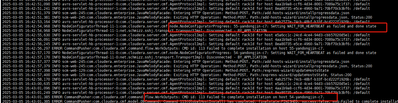

d) /var/log/cloudera-scm-server/cloudera-scm-server.log No error is displayed. Only one agent fails to be deployed
