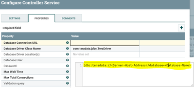

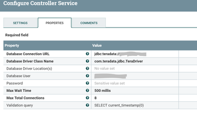

As per your logs
Caused by: java.sql.SQLException: [Teradata Database] [TeraJDBC 16.00.00.23] [Error 3807] [SQLState 42S02] Object 'DIM_PROD' does not exist.
dim_prod does not exist make sure you are connecting to right database.
In your JDBC connection string in connection pool, if you have mentioned database name then check the table dim_prod exists in that database.
Sample Teradata JDBC connection string:-
Make sure you are having the below jars in your nifi lib path.
Teradata Connection Pool Configs:-
If above jars not in nifi lib path then you need to give path to all those jars with comma separated list.
| Database Driver Location(s) | Comma-separated list of files/folders and/or URLs containing the driver JAR and its dependencies (if any). For example '/var/tmp/mariadb-java-client-1.1.7.jar' Supports Expression Language: true |
For both cases
Database Driver Class Name property should be
com.teradata.jdbc.TeraDriver

Created 12-11-2017 05:55 AM
thanks, I was missing "/database" in connection URL.

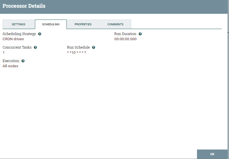

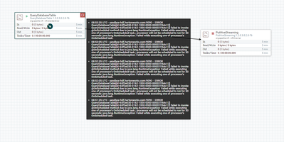

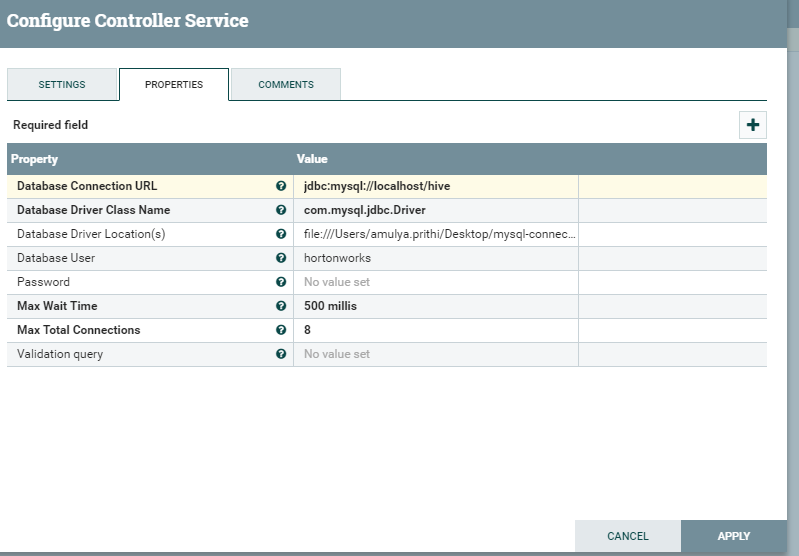

Created on 04-06-2018 09:41 AM - edited 08-17-2019 07:27 PM
Iam new to NIFI i want to sqoop the data from Mysql to Hive,and i am using HDP 2.6,I have configured QueryDatabasetable Processor with DBCP and enable the same but when iam trying to start the processor i could see the below error.Please help me out.
