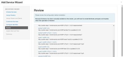

I think my problem for failing ranger KMS install was wrong Kerberos setup as you see from the attached screen its complaining about Kerberos being installed manually.
So how I do I install Kerberos "NOT manually" ?
