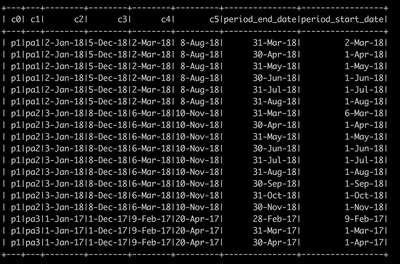

I used 2 udfs here
1) getLastDaysBetweenDates - Consumes a date format, start and end dates and returns a list of Month End Dates in this range
2) getFirstDateFromLastDateAndReference - Consumes a date format, a start date and an end date. Returns the first date of the month based on the last date. However for the first month, it returns the pa_start_date instead of the First Calendar date.
Super Collaborator
Output Data of the form
