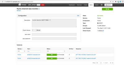

This is the step that i followed:
1). Copied the "flume_monitor.py" script to ambari server "/var/lib/ambari-server/resources/host_scripts" location.
# scp  /Users/jsensharma/Downloads/40443-test/flume_monitor.py   root@amb25101:/var/lib/ambari-server/resources/host_scripts
2). Now i pushed the alert definition to my ambari cluster.
# curl -u admin:admin -i -H 'X-Requested-By:ambari' -X POST -d @/Users/jsensharma/Downloads/40443-test/flume_monitor.json  http://amb25101.example.com:8080/api/v1/clusters/plain_ambari/alert_definitions
HTTP/1.1 100 Continue
HTTP/1.1 201 Created
X-Frame-Options: DENY
X-XSS-Protection: 1; mode=block
X-Content-Type-Options: nosniff
Cache-Control: no-store
Pragma: no-cache
Set-Cookie: AMBARISESSIONID=j2au8meo5w73182sf1wnjn9z8;Path=/;HttpOnly
Expires: Thu, 01 Jan 1970 00:00:00 GMT
User: admin
Content-Type: text/plain
Content-Length: 0
3). Restarted Ambari Server.
# ambari-server  restart
4). Checked the Ambari UI.
My Cluster Details:
[root@amb25101 ambari-server]# ambari-server --version
2.5.1.0-159
[root@amb25101 ambari-server]# python --version
Python 2.7.5
