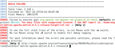

i have problem when i try write command "mvn clean install" on centos 7

i have problem with "mvn clean install" please help me

Can you try adding "-Drat.skip" something like following to see if it proceeds:
# mvn clean install -Drat.skip
OR
# mvn clean install -Drat.skip=true
This will skip the plugin execution, e.g. for technical builds that do not take license compliance into account.
http://creadur.apache.org/rat/apache-rat-plugin/check-mojo.html#skip

thanks for your attention with my problem, but that not success fix my problem

Hey
@anggit wisnu, you could also try mvn clean package -DskipTests
first to check if it runs properly, and then run mvn install
Also, can you also tell more about your test environment, version of metron you are using? Preferably paste the output of metron-deployment/scripts/platform-info.sh
command.

@asubramanian my metron version is 0.3.1 and my error in stellar-common test.

@anggit wisnu - did you try with the mvn clean package -DskipTests
option to see if it works?
Also, can you execute the platform-info.sh
script and paste the output from running it. Here is a sample output from my environment.

You could just put this extra switch to your mvn cmd:
-Drat.numUnapprovedLicenses=100
or
-DskipITs

When cloning and building Metron locally you have to be careful about adding extra files within your local copy. There is a plugin that runs (Apache Rat) that checks for licenses whenever you build. You likely added some files that don't have license headers and your best bet is to remove the files flagged in /path/to/metron/target/rat.txt.
