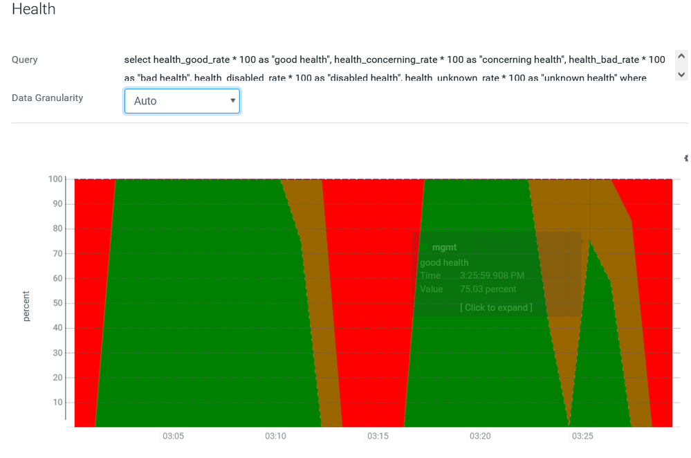

I do anything, and after the upgrade, I found the cloudera-scm-agent is not stable.
the cloudera-scm-agent log is:
[26/Jul/2023 15:11:31 +0000] 1956 MainThread filesystem_map ERROR NFS server binding info failed with error :- rpcinfo: RPC: Port mapper failure - Timed out
program 100003 is not available
[26/Jul/2023 15:12:31 +0000] 1956 MainThread filesystem_map ERROR NFS server binding info failed with error :- rpcinfo: RPC: Port mapper failure - Timed out
[26/Jul/2023 15:13:31 +0000] 1956 MainThread filesystem_map ERROR NFS server binding info failed with error :- rpcinfo: RPC: Port mapper failure - Timed out
[26/Jul/2023 15:14:31 +0000] 1956 MainThread filesystem_map ERROR NFS server binding info failed with error :- rpcinfo: RPC: Port mapper failure - Timed out
[26/Jul/2023 15:15:31 +0000] 1956 MainThread filesystem_map ERROR NFS server binding info failed with error :- rpcinfo: RPC: Port mapper failure - Timed out
[26/Jul/2023 15:16:31 +0000] 1956 MainThread filesystem_map ERROR NFS server binding info failed with error :- rpcinfo: RPC: Port mapper failure - Timed out
[26/Jul/2023 15:16:32 +0000] 1956 MainThread agent ERROR Heartbeating to mysiteaddress.com:7182 failed.
Any suggestions? Thank you!!

After I change to monitored_nodev_filesystem_types=tmpfs in /etc/cloudera-scm-agent/config.ini,
it solve my problem.
Master Collaborator
Glad you resolved the issue. Just to add more context, The error indicates agent was unable to monitor the filesystem, likely the nfs is stuck. This results in agent to be stuck in monitoring the filesystem and unable to heartbeat to CM server. Hence Removing the NFS from monitored filesystem helped to resolve the issue.
