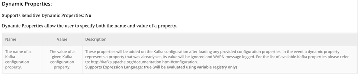

@Rohit1997jio
Most NiFi processors that are "started/running" are not continuously consuming threads. The processor configurable scheduling controls how often the component processor requests a thread from the NiFi controller thread pool to execute it's code.  By default processors have a run schedule of 0 which means that the processor would get scheduled to run as often as possible. Should execution result in no processing of data (FlowFiles), NiFi controller will delay next scheduled execution of that processor for 1 sec before it can be scheduled again (this logic prevents excessive CPU usage by processor components).
The Kafka processors simply execute Kafka Client libraries and support adding dynamic properties to the processors configuration that impact that client library behavior.  The Apache NiFi documentation for each component will identify if "Dynamic Properties" are supported:
https://nifi.apache.org/docs/nifi-docs/components/org.apache.nifi/nifi-kafka-2-6-nar/1.24.0/org.apac...
In the case of the consume and publish Kafka component processors, dynamic properties are supported.  The dynamic properties are  limited to those allowed by the specific kafka client library version:
https://kafka.apache.org/documentation.html#configuration

@Rohit1997jio
