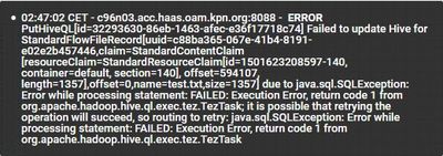

when I send the above to puthive ql, I am getting the below error.

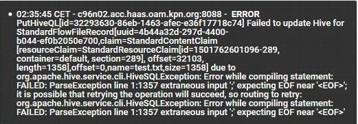

I thought it is because of the ";" in the end of insert into statement, so I removed it, then I am getting the below error
Please help me.
