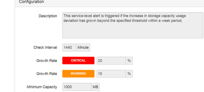

Looks like you are looking at the "HDFS Storage Capacity Usage (Weekly)" alert. This service-level alert is triggered if the increase in storage capacity usage deviation has grown beyond the specified threshold within a week period.
The default alert definition says:
Show a WARNING (YELLOW) message when the HDFS usage grows more than 10% in a week
Show a CRITICAL (RED) message when the HDFS usage grows more than 20% in a week

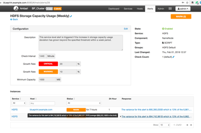

With this kind of alert you will see a message also at the bottom something like following which i got in my environment:
The variance for this alert is 895,395,035B which is 13% of the 6,861,760,545B average (686,176,054B is the limit)
This says that my HDFS usage growth was 13% compared to last week so based on the threshold value ambari shows it as a WARNING.

I checked and we got - The variance for this alert is 6,233,496,816B which is 74% of the 8,471,125,314B average (1,694,225,063B is the limit) , so as I understand we cant do nothing about this , only to update the thershold - am I right ?

ok so in order to avoid this alarm we can set "Growth Rate" from 20% to 40% , or to increase minimum capacity from 1000 to 5000 , what is the better option ?
