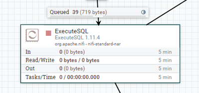

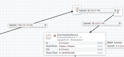

I have a three-node NiFi cluster. I use this to ingest data from multiple source systems. From time to time, we experience this issue where the flowfiles are getting stucked in round robin queues and just sit idly there.
I've also tried adding funnels just to test if they can still proceed downstream.
Upon monitoring the disk usage of the cluster, it never exceeds 30% utilization.
Anyone knows what's causing this issue? Tried checking the nifi-app logs but no luck.
Thank you!
4 REPLIES 4
New Contributor
Also note that all of the stucked flowfiles are in the same node. Restarting the node typically solves the issue but I want to prevent this issue from happening again.

@databoi
I see from your images that you are using Apache NiFi 1.11.4 which is around the time that the Load Balanced connection capability was introduced.  There were many bugs subsequently identified in load balanced connection and addressed in future releases. I strongly encourage you to upgrade to the latest NiFi release and see if your issue persists.
