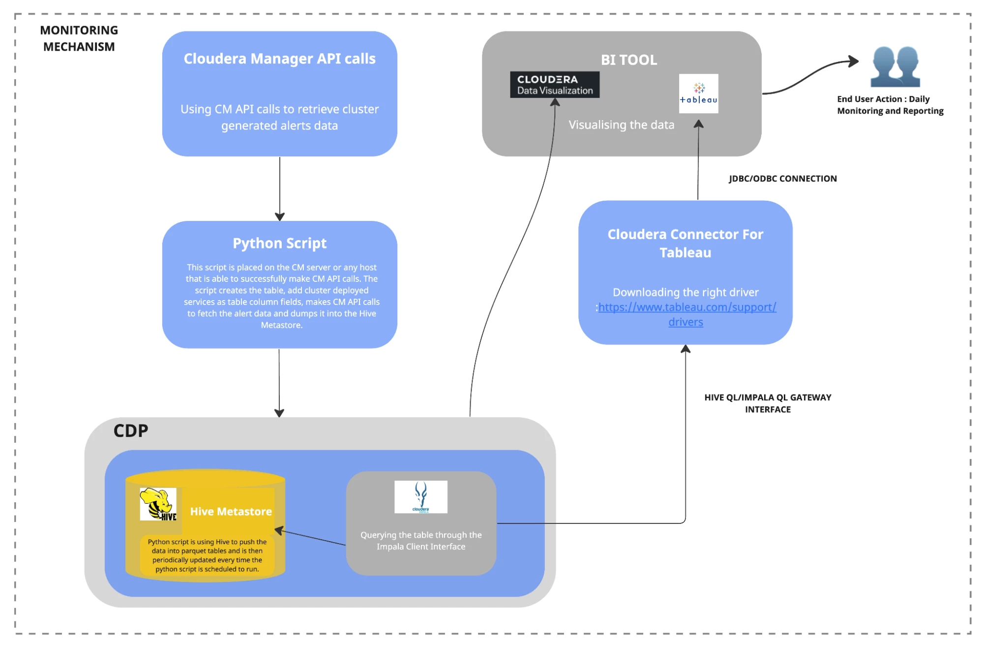

Troubleshoot critical impala query failures more accurately and near real-time using a combination of Cloudera Manager (CM) API, Nifi, and BI tools to:
  • Gain automated visibility, transparency, and alerts of impala query failures
  • Continuously monitor and track Impala's health
  • Identify, classify, and label critical failure types (10) to address and types to ignore
  • Quickly identify critical failure causes
  • Visualize failures in one place including trends by count and failure rates
  • Access actionable insights to recover from incidents quickly and prevent future failures
  • Automate end-user issue notification

Solution Pattern
Note: This approach works for CDP Base and Data Hub, and is not supported for CDW Public or Private cloud.
The implementation steps in the PDF attached to this article will guide you to implement the impala query monitoring and alerting mechanism and build the dashboards.
