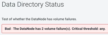

Cloudera Manager Notification
One easy method to identify that you have experienced a disk failure within your cluster is with the Cloudera Manager UI. You will see the following type of error:

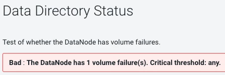

Cloudera Manager will also track multiple disk failures:
HDFS NameNode - DataNode Volume Failures

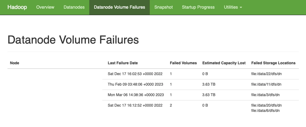

The failed disks within your cluster can also be observed from within the HDFS NameNode UI:
This is also useful to quickly identify exactly which storage locations have failed.
Confirming from the Command Line
Taking the last example from HDFS NameNode - DataNode Volume Failures, we can see that /data/20 & /data/6 are both failed directories.

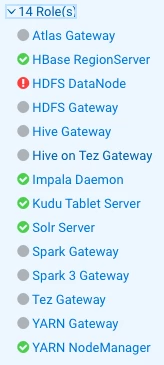

You will have a number of roles that are running on any single worker node host. This is an example of a worker node that is showing a failed disk:

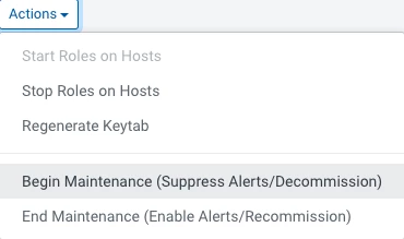

As there are multiple roles running on a worker node, it’s best to use the decommissioning process to gracefully remove the worker node from running services. This can be found by navigating to the host within Cloudera Manager and using “Actions > Begin Maintenance”

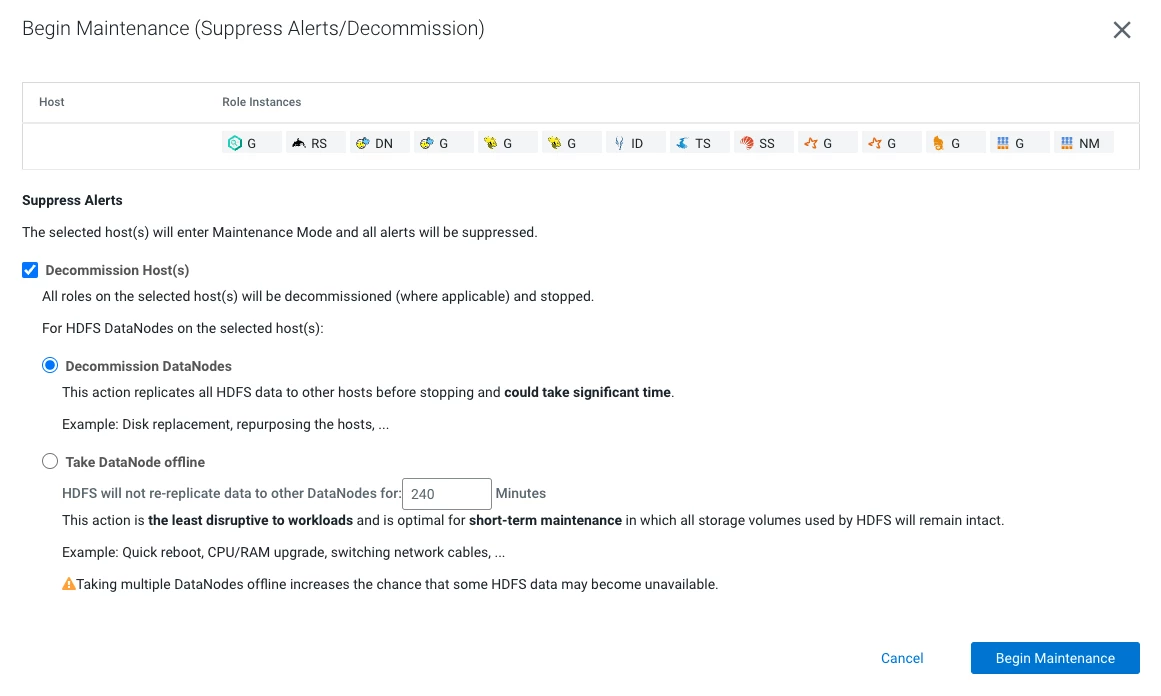

It will then take you to the following page:
Click “Begin Maintenance” and wait for the process to complete.
Expect this process to take hours on a busy cluster. The time the process takes to complete is dependent upon:
  • The number of regions that the HBase RegionServer is hosting
  • The number of blocks that the HDFS DataNode is hosting
  • The number of tablets that the Kudu TabletServer is hosting

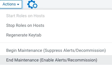

Once the disk(s) has been suitably replaced, it’s time to use the recommissioning process to gracefully reintroduce the worker node back into the cluster. This can be found by navigating to the host within Cloudera Manager and using “Actions > End Maintenance”
After the node has completed its recommission cycle, follow the guidance in the next sections to perform local disk rebalancing where appropriate.
