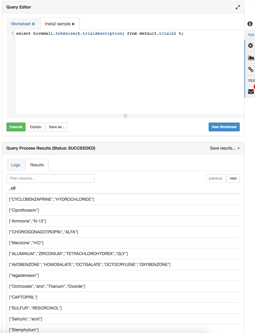

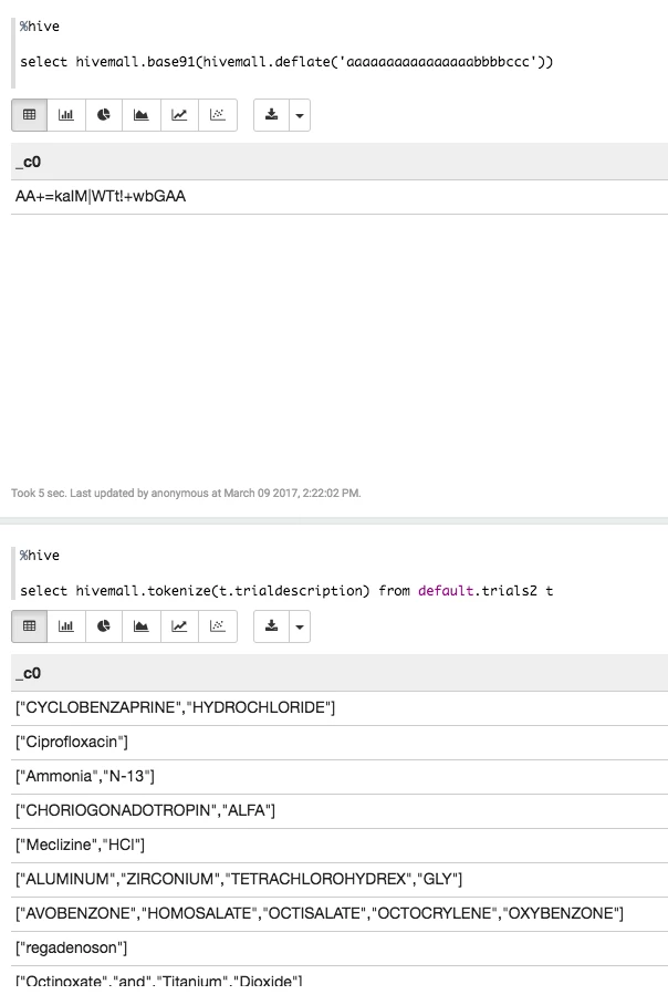

Apache HiveMall
HiveMall was developed by developers from Treasure Data, NTT and Hortonworks.
- https://community.hortonworks.com/articles/67983/apache-hive-with-apache-hivemall.html
- https://www.slideshare.net/HadoopSummit/hivemall-scalable-machine-learning-library-for-apache-hivesparkpig
- http://hivemall.incubator.apache.org/userguide/getting_started/permanent-functions.html
- http://hivemall.incubator.apache.org/userguide/getting_started/installation.html
- http://github.com/myui/hivemall
set hivevar:hivemall_jar=hdfs:///apps/hivemall/hivemall-with-dependencies.jar;
source /opt/demo/define-all-as-permanent.hive;
HiveMall is a scalable machine learning library built as a collection of Hive UDFs that you can run through Hive, Spark and Pig. It brings very cool processing to your Hive queries, Zeppelin, Pig and Spark code. You will be able to combine Hive Mall machine learning with stored procedures on in-memory fast LLAP Hive. This is revolutionary. You can run this via near real-time Apache NiFi streams.
