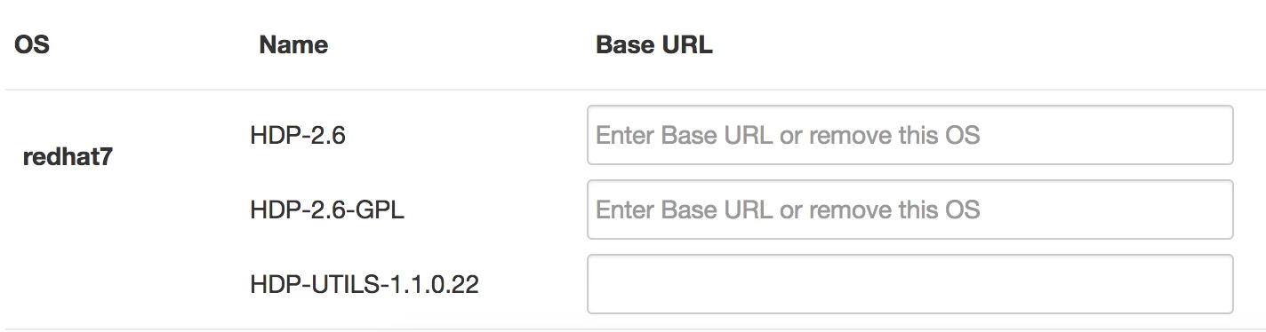

LZO compression libraries use a GPL license, which differs from rest of the packages in Ambari/HDP which are Apache licensed. Hence, the need for a separate repo which is named ‘HDP-<version_number>-GPL’. The Version Definition File (VDF) starting HDP-2.6.4.0 release has been updated to include the new ‘HDP-2.6-GPL’ repo. Refer the sample VDF file for CentOS7 here. Here is a snippet from Ambari web UI for the new 'HDP-2.6-GPL' field:

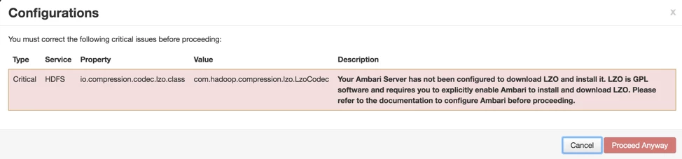

What happens when you try to configure core-site with LZO configs and GPL license is not accepted?
Ambari’s stackadvisor has a check to validate such configs. In the current scenario, you would get the following error message:
