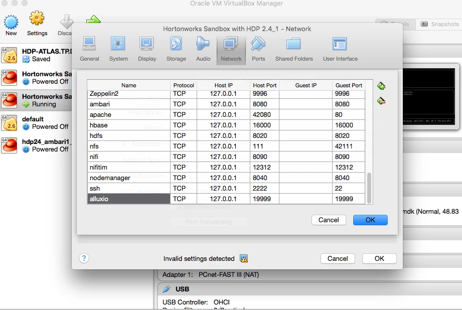

To use on HDP, you need to edit the /opt/alluxio-1.0.1/conf/alluxio-env.sh after you create it and change the port from 9000 to 8020.
You can also override at the command line:
export
ALLUXIO_UNDERFS_ADDRESS=hdfs://localhost:8020

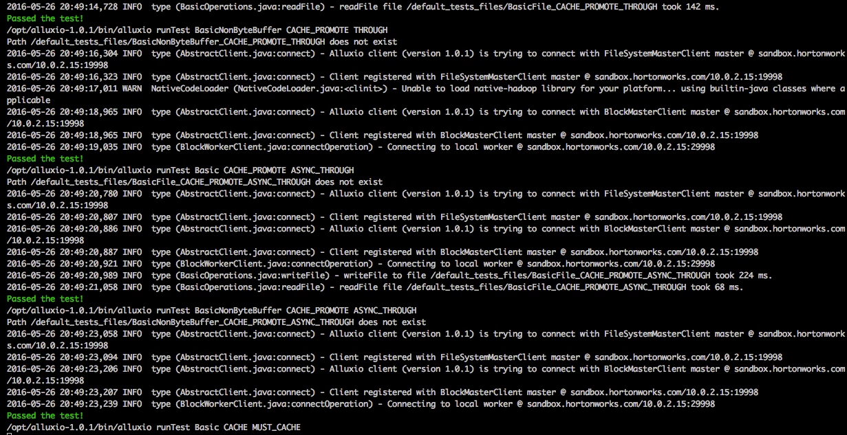

To validate your install, run the tests:
./bin/alluxio runTests
All tests passed

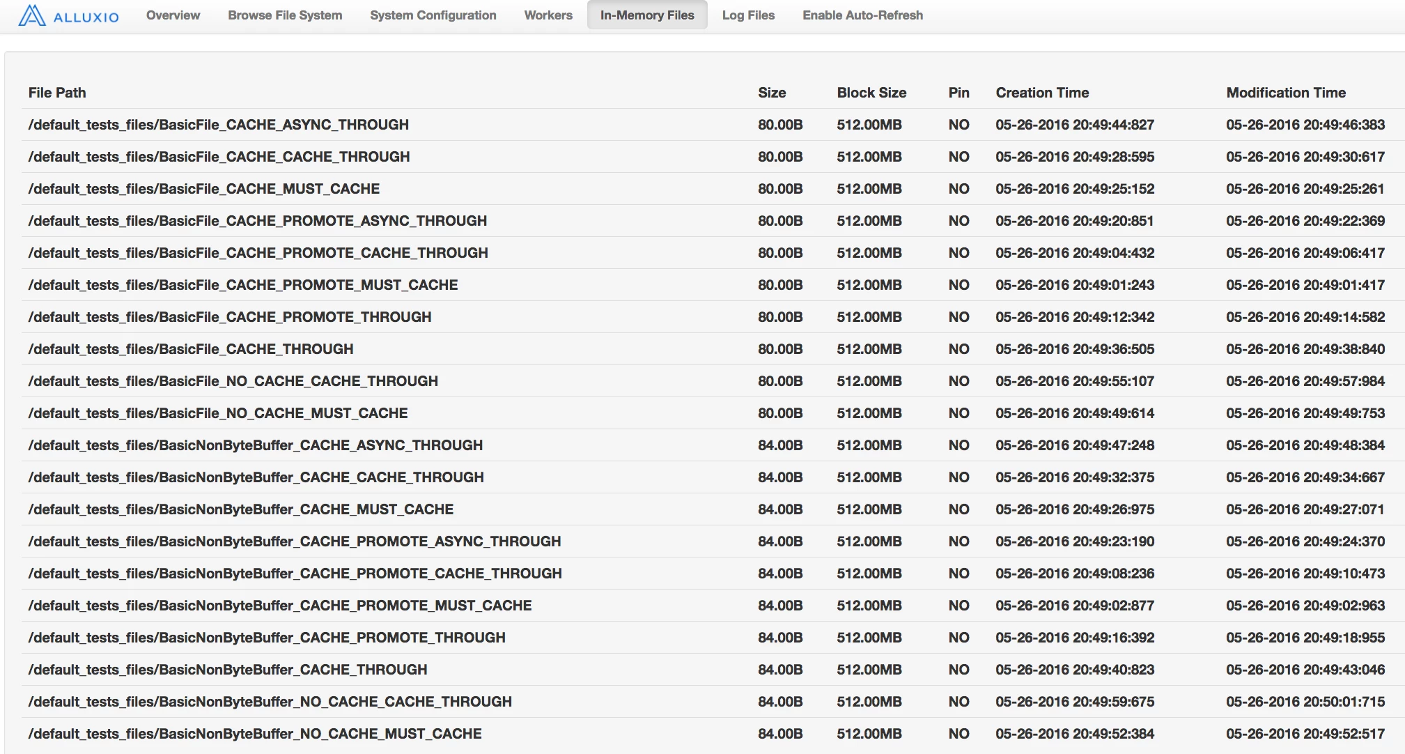

You can view from the command line ( http://www.alluxio.org/documentation/en/Command-Line-Interface.html )
[root@sandbox
alluxio-1.0.1]# ./bin/alluxio fs ls /default_tests_files
80.00B 05-26-2016 20:49:01:243 In Memory
/default_tests_files/BasicFile_CACHE_PROMOTE_MUST_CACHE
84.00B 05-26-2016 20:49:02:877 In Memory
/default_tests_files/BasicNonByteBuffer_CACHE_PROMOTE_MUST_CACHE
80.00B 05-26-2016 20:49:04:432 In Memory
/default_tests_files/BasicFile_CACHE_PROMOTE_CACHE_THROUGH
84.00B 05-26-2016 20:49:08:236 In Memory
/default_tests_files/BasicNonByteBuffer_CACHE_PROMOTE_CACHE_THROUGH
80.00B 05-26-2016 20:49:12:342 In Memory
/default_tests_files/BasicFile_CACHE_PROMOTE_THROUGH
84.00B 05-26-2016 20:49:16:392 In Memory
/default_tests_files/BasicNonByteBuffer_CACHE_PROMOTE_THROUGH
80.00B 05-26-2016 20:49:20:851 In Memory
/default_tests_files/BasicFile_CACHE_PROMOTE_ASYNC_THROUGH
84.00B 05-26-2016 20:49:23:190 In Memory
/default_tests_files/BasicNonByteBuffer_CACHE_PROMOTE_ASYNC_THROUGH
80.00B 05-26-2016 20:49:25:152 In Memory
/default_tests_files/BasicFile_CACHE_MUST_CACHE
84.00B 05-26-2016 20:49:26:975 In Memory
/default_tests_files/BasicNonByteBuffer_CACHE_MUST_CACHE
80.00B 05-26-2016 20:49:28:595 In Memory
/default_tests_files/BasicFile_CACHE_CACHE_THROUGH
84.00B 05-26-2016 20:49:32:375 In Memory
/default_tests_files/BasicNonByteBuffer_CACHE_CACHE_THROUGH
80.00B 05-26-2016 20:49:36:505 In Memory
/default_tests_files/BasicFile_CACHE_THROUGH
84.00B 05-26-2016 20:49:40:823 In Memory
/default_tests_files/BasicNonByteBuffer_CACHE_THROUGH
80.00B 05-26-2016 20:49:44:827 In Memory
/default_tests_files/BasicFile_CACHE_ASYNC_THROUGH
84.00B 05-26-2016 20:49:47:248 In Memory
/default_tests_files/BasicNonByteBuffer_CACHE_ASYNC_THROUGH
80.00B 05-26-2016 20:49:49:614 In Memory
/default_tests_files/BasicFile_NO_CACHE_MUST_CACHE
84.00B 05-26-2016 20:49:52:384 In Memory
/default_tests_files/BasicNonByteBuffer_NO_CACHE_MUST_CACHE
80.00B 05-26-2016 20:49:55:107 In Memory
/default_tests_files/BasicFile_NO_CACHE_CACHE_THROUGH
84.00B 05-26-2016 20:49:59:675 In Memory
/default_tests_files/BasicNonByteBuffer_NO_CACHE_CACHE_THROUGH
80.00B 05-26-2016 20:50:03:639 Not In Memory
/default_tests_files/BasicFile_NO_CACHE_THROUGH
84.00B 05-26-2016 20:50:07:425 Not In Memory
/default_tests_files/BasicNonByteBuffer_NO_CACHE_THROUGH
80.00B 05-26-2016 20:50:11:384 In Memory
/default_tests_files/BasicFile_NO_CACHE_ASYNC_THROUGH
84.00B 05-26-2016 20:50:13:310 In Memory
/default_tests_files/BasicNonByteBuffer_NO_CACHE_ASYNC_THROUGH

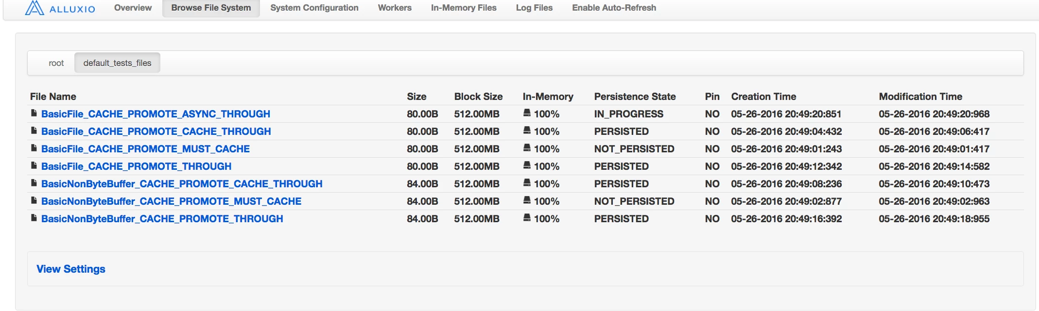

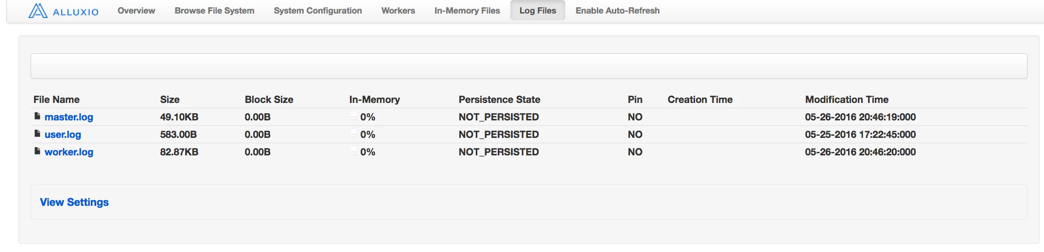

You can access these files from Spark and Flink. Alluxio has configurable storage tiers (memory, HHD, SSD) and can sit on top of HDFS.

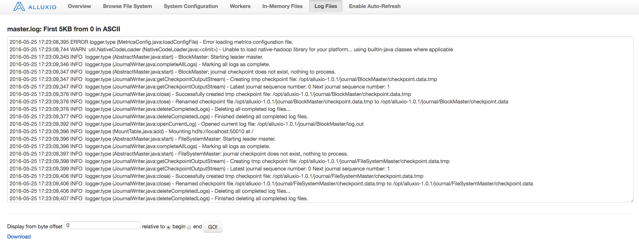

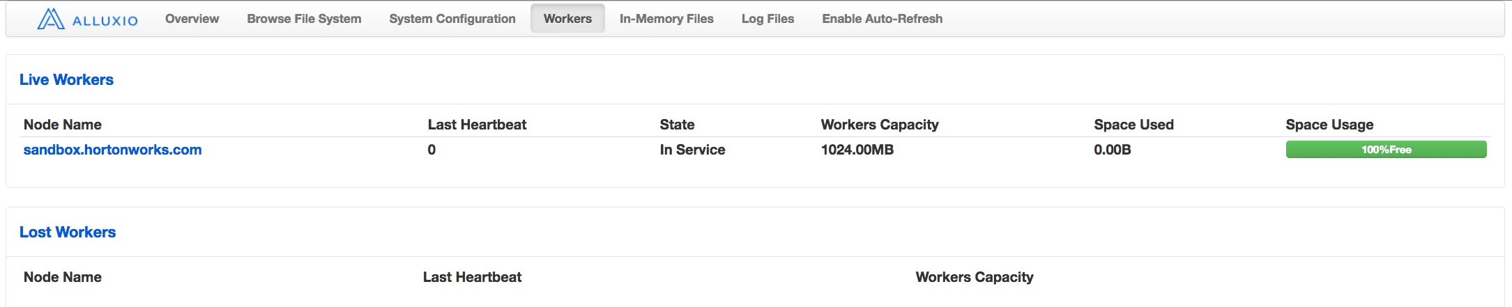

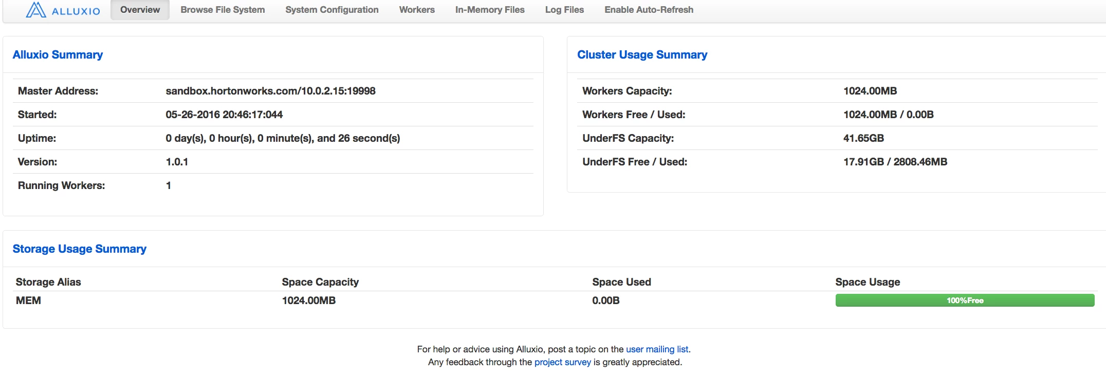

To Browse The Alluxio File System and Also View Metrics
http://localhost:19999/home
