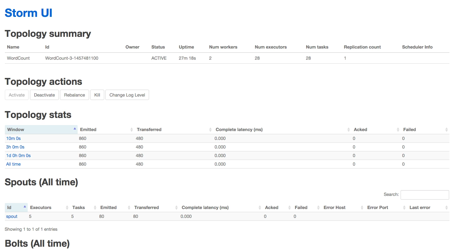

Gather data using Storm UI and other tools specific to the environment. Storm UI is your first to go-to tool for tuning, most of the time.

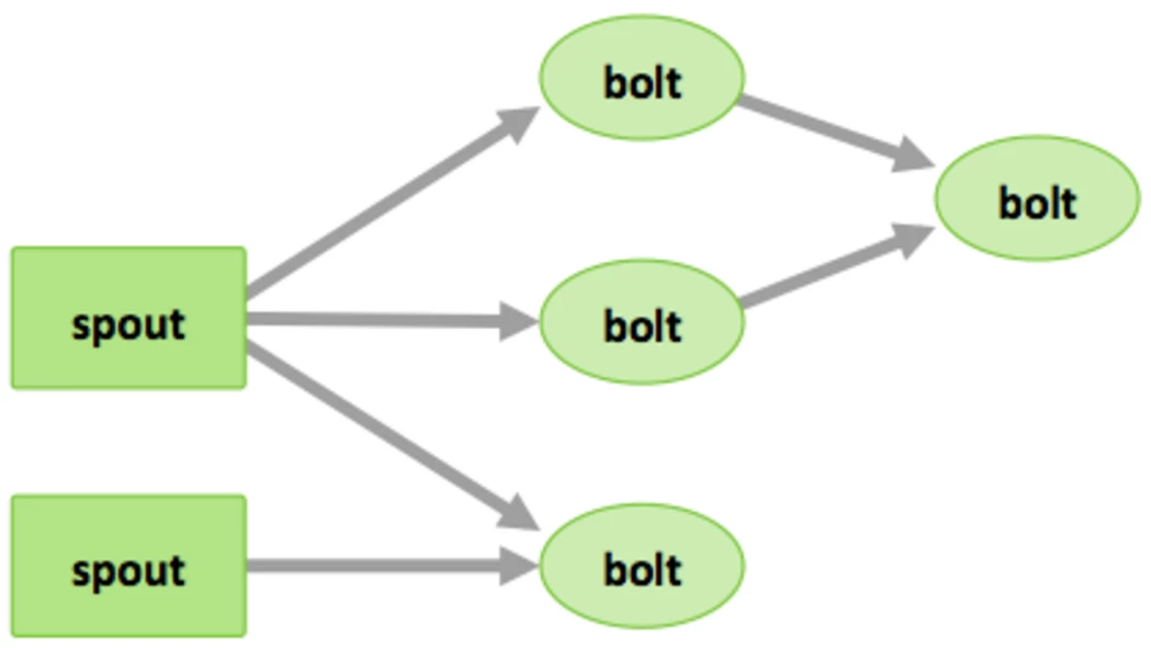

In a storm topology, you have spouts, bolts, workers that can play a role in your topology challenges.
Learn about topologies status, uptime, number of workers, executors, tasks, high-level stats across four time windows, spout statistics, bolt statistics, visualization of the spouts and the bolts and how they are connected, the flow of tuples between all of the streams, all configurations for the topology.

  1. Increase parallelism (use rebalance command), analyze the change in capacity using the same Storm UI – if no improvement, focus on the bolt, that is the likely bottleneck; if you see backlog in your upstream (Kafka most likely), focus on the spout. After trying with spouts and bolts, change focus on workers’ parallelism. Basic principle is to scale on a single worker with executors until you find increasing executors does not work anymore. If adjusting spout and bolt parallelism failed to provide additional benefits, play with the number of workers to see if we are now bound by the JVM we were running on and needed to parallelize across JVMs.
