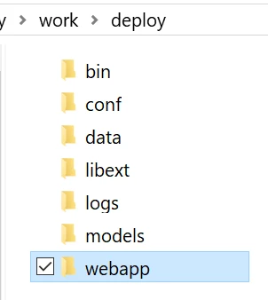

Deploy Directory Setup
Create a directory say Deploy (say c:\work on Windows or ~/work on Mac) with a structure below it:
  • conf
    • Copy atlas-application.properties, users-credentials.properties, policy-store.txt atlas-log4j.xml and atlas-env.sh here.
    • Use contents of the attached ZIP.
  • data
    • During runtime, the backend database will create its files here. This may be a location to check.
  • data/solr
    • Copy contents C:\work\atlas\repository\src\test\resources\solr to c:\deploy\data\ for Windows (from ~/Apache/atlas/repository/src/test/resources to ~/Deploy/data on Mac).
  • libext
    • Copy BerkeleyDB JAR here, say je-5.0.73.jar
  • logs
    • Logs will be created here.
  • models
    • Copy contents from c:\work\atlas\addons\models (or ~/Apache/atlas/addons/models for Mac.)
  • webapp (optional)
    • Deploy the contents of atlas.war here if you are developing on client-side (UI).
  • bin (optional)
    • Empty for now.
When done, your directory layout should look like this:

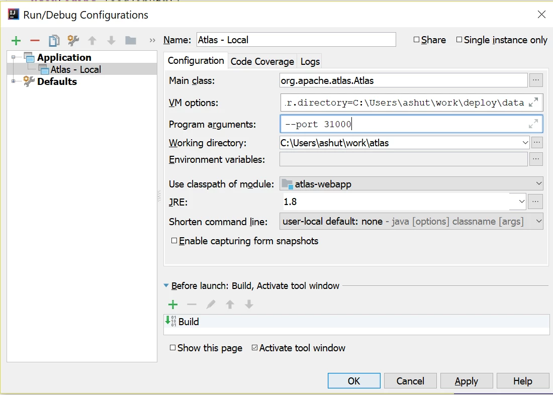

IntelliJ: 'Atlas - Local' Configuration
From IntelliJ's Run/Edit Configurations menu option, create a new configuration, call it 'Atlas - Local'.
Details are:
  • Type: Application
  • Main class: org.apache.atlas.Atlas

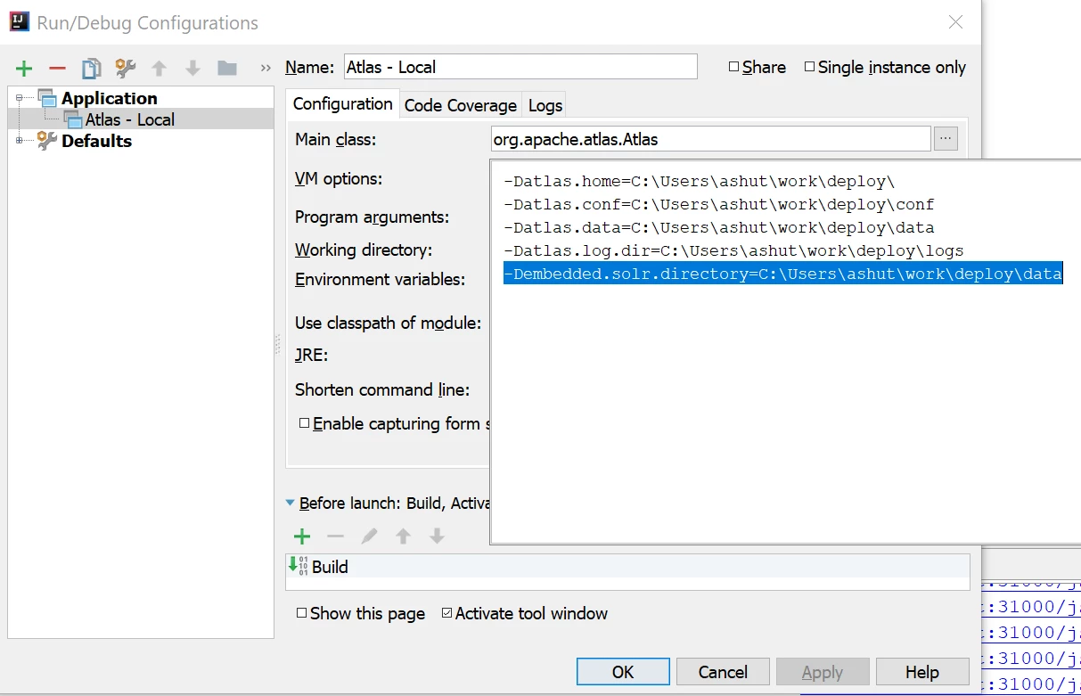

  • VM options: These should reflect location of your directory created in the step above. Add the following:
    • -Datlas.home=C:\work\deploy\ -Datlas.conf=C:\work\deploy\conf -Datlas.data=C:\work\deploy\data -Datlas.log.dir=C:\work\deploy\logs -Dembedded.solr.directory=C:\work\deploy\data
    • (See screen shot Profile-2)
  • Program arguments: --port 31000
    • This is needed so that Atlas that is being run from IntelliJ does not clash with another version that runs on the development VM.
  • Working directory: Set this to the location of webapp of your code base. (In my case, c:\work\apache\atlas on Windows and ~/Apache/atlas/ on Mac)
  • Use classpath of module: atlas-webapp
See screen shots below.
