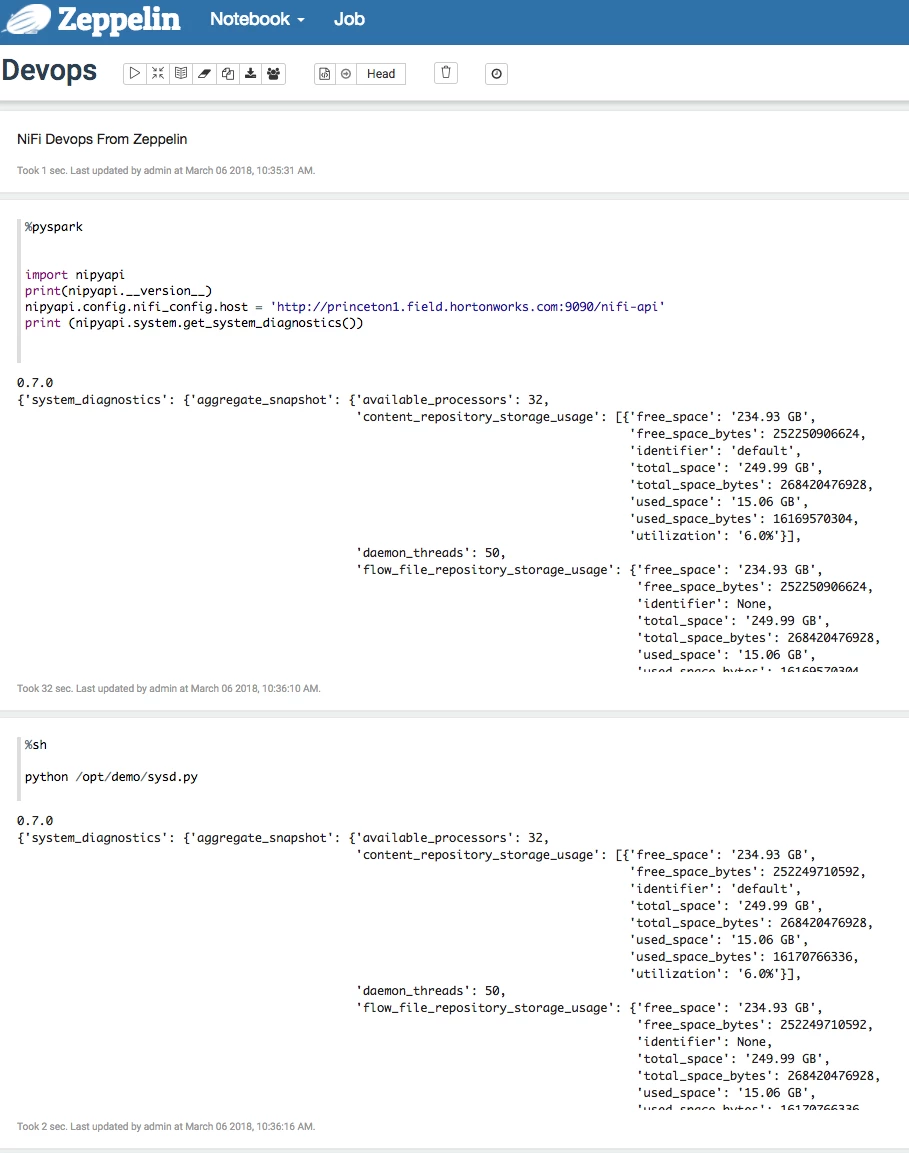

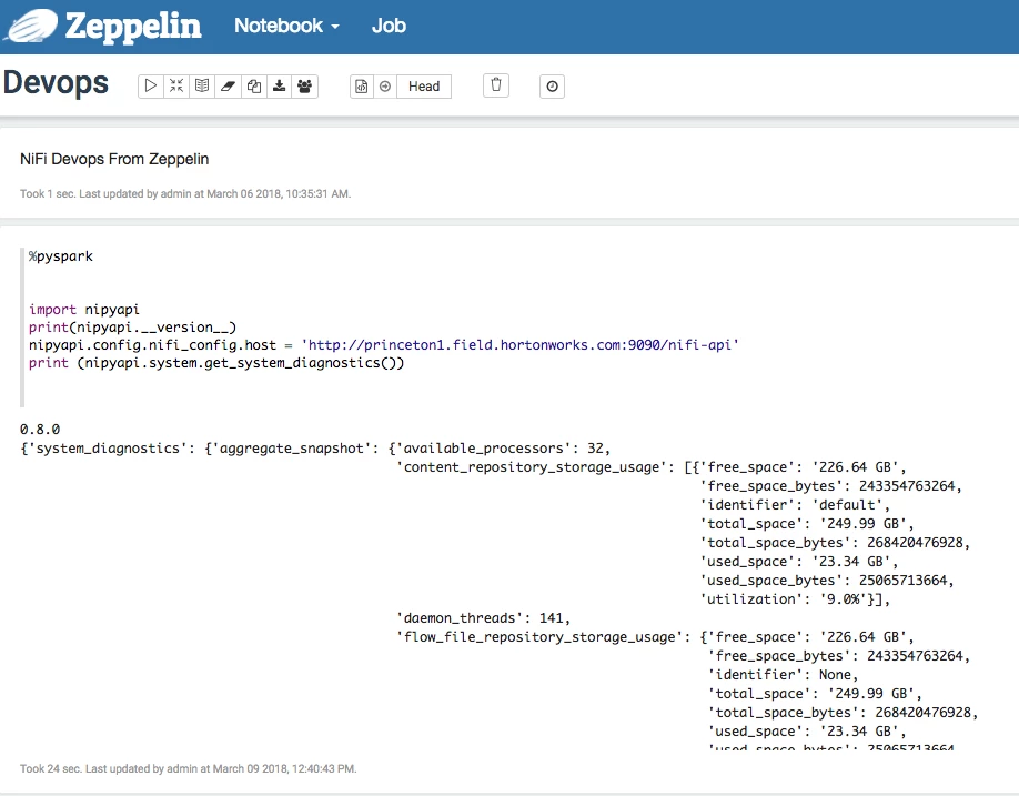

I ran this on a HDF server on Centos 7 and got a pretty nice example demo run.
python3.6 conso.py
0.8.0

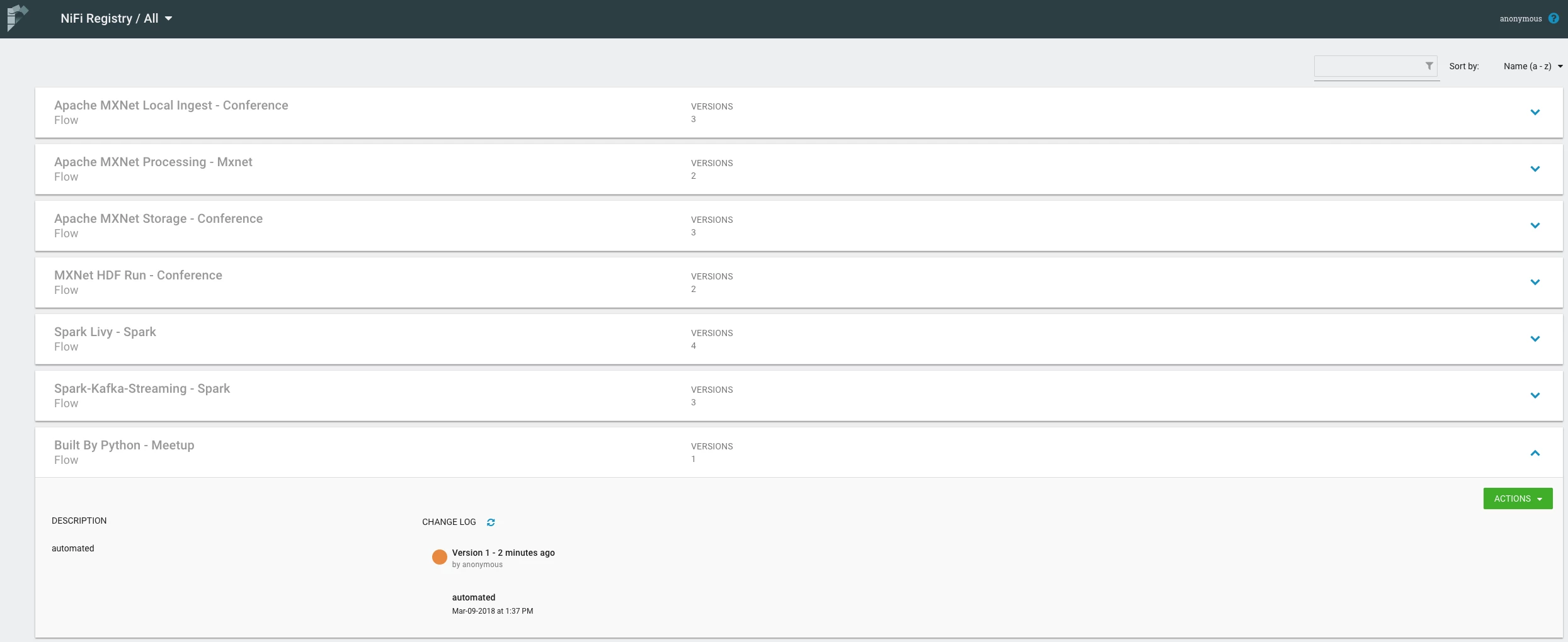

Save a Flow Version to Registry***
rgcid = 'nipyapi_console_reg_client_0'
registry_client = nipyapi.versioning.get_registry_client(rgcid, identifier_type='name')
identifier = 'nipyapi_console_process_group_0'
process_group = nipyapi.canvas.get_process_group(identifier, identifier_type='name')
bucketid = 'meetup'
bucket = nipyapi.versioning.get_registry_bucket(bucketid, identifier_type='name')
print(nipyapi.versioning.save_flow_ver(process_group, registry_client, bucket, flow_name='built by python', flow_id=None, comment='automated', desc='automated', refresh=True))
You grab a process group, pick up a bucket and save your verison there.
Example Output
{'process_group_revision': {'client_id': 'adc045ac-3eb5-1e1a-9861-68c932e967e9',
'last_modifier': None,
'version': 3},
'version_control_information': {'bucket_id': 'd80946af-64be-471a-baf8-d85fa98d0a19',
'bucket_name': 'meetup',
'flow_description': 'automated',
'flow_id': '64f37030-6c0f-4272-b16c-cb8a0119e776',
'flow_name': 'built by python',
'group_id': 'e2794288-daa1-173a-ffff-ffffdadbf3f8',
'registry_id': 'adc0435b-3eb5-1e1a-ffff-fffff521cba3',
'registry_name': 'nipyapi_console_reg_client_0',
'state': 'UP_TO_DATE',
'state_explanation': 'Flow version is current',
'version': 1}}
