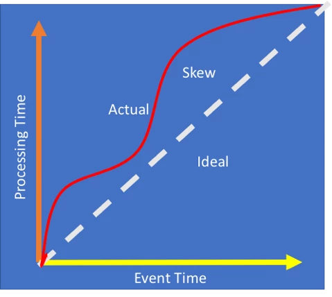

Event Time – The time that the event occurred
Processing Time – The time that the event was observed in the processing system
In an ideal world, these two times would be the same or very close. However, in the real world there is always some time lag or “skew”. And, this skew may be significant, and this exists whether you are processing events in batches or in near real-time.
This skew can be caused by many different factors including
Resource Limitations – Bandwidth, CPU, etc. may not allow events to be immediately forwarded and processed.
Software Features/Limitations – Software may be intentionally programmed to queue events and send them at predetermined times. For example, cable TV boxes that report information once or twice a day, or fitness trackers that send some information, such as sleep data only daily.
Network Discontinuity – Any mobile application needs to plan for disruptions in Internet connectivity. Whether because of dead-spots in wireless coverage, airplane-mode, or dead batteries, these interruptions can happen regularly. To mitigate these, any good mobile app will queue event messages for sending the next time that a connection is available, which may be minutes or months!

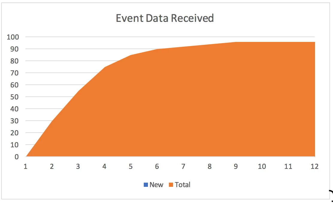

Completeness—When event data can come in for some time past the end of a time window, it is very difficult to assess the completeness of the data. Most the data may arrive within a period (hour or day) of the time window. However, data may continue to trickle in for quite some time afterwards. This presents issues of
  • Processing and combining data that arrives over time
  • Determining a cutoff when data is considered complete
As we can see in this figure, most event data is received in the few windows after the event time. However, data continues to trickle in, and in fact, 100% theoretical completeness may never be achieved! So, if we were to report on the event data at day 3 and at day 7 the results would be very different.

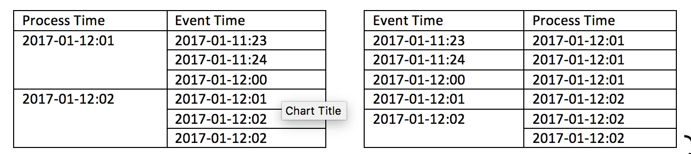

Restatement—By this we mean the restatement of data that has arrived and been grouped by process time into our desired dimension of event time. This would not be an issue if we could simply scan through all the data each time we want to analyze it, but this becomes unworkable as the historical data grows. We need to find a way to process just the newly arrived data and combine it with the existing data.
