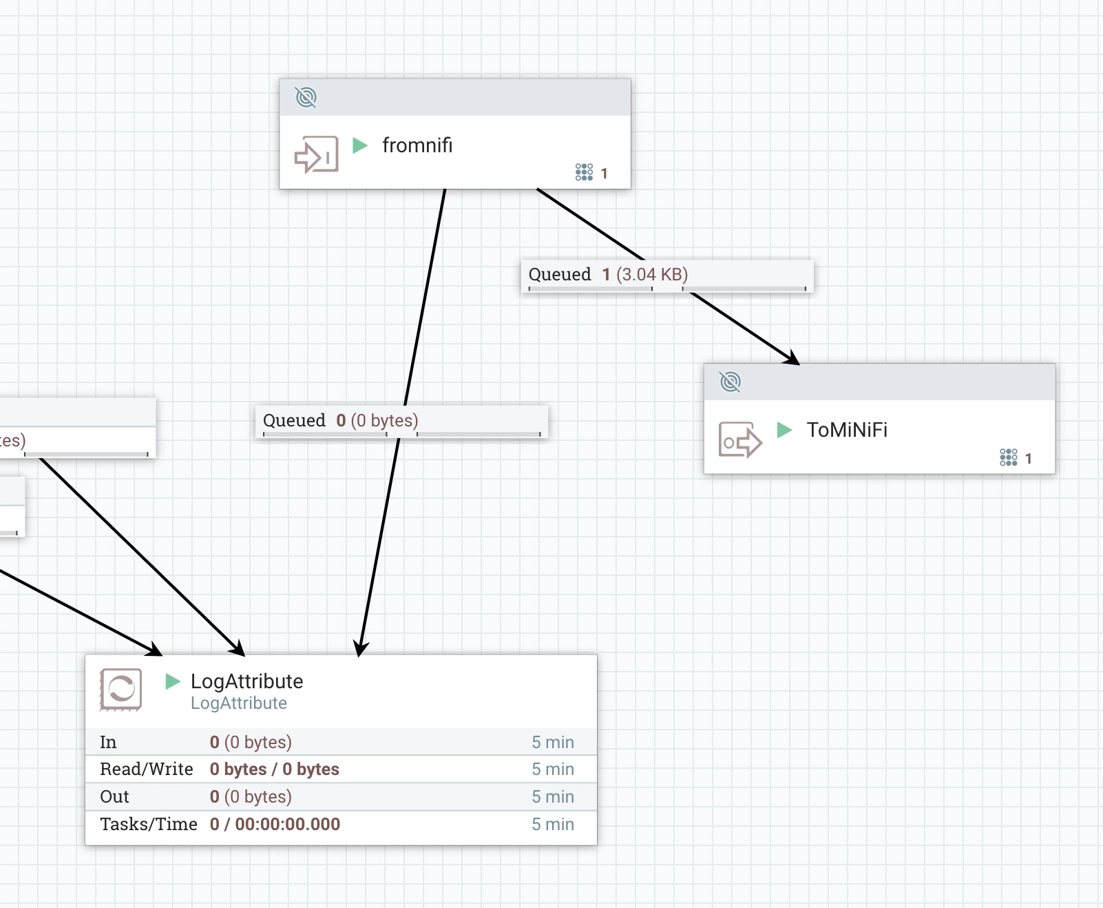

Using a C++ Apache Accumulo client [2], we’ve created a branch of Apache MiNiFi that has extensions [3] built for Apache Accumulo. These extensions are built to simply take content from a flow and put the textualized form of the attributes and content and place it into the Apache Accumulo value. The data is then stored into an Apache Accumulo specific data format known as an RFile[4]. The keys and values are stored into the Rfile and then send to the NiFi instance via the Site-To-Site protocol. Figure 1, below, shows the input and output ports we have configured. Using this information we are able to create a configuration YAML file for Apache MiNiFi that uses the Apache Accumulo writer [5]. This YAML file will simply take an input from a GetFile processor and ship this to the NiFi instance. In the example from paste bin you can see that data is sent to the fromnifi RPG and then immediately shipped back to ToMiNiFi, where we bulk import the Rfiles
Figure 1: Apache NiFi view of Input and Output ports.
