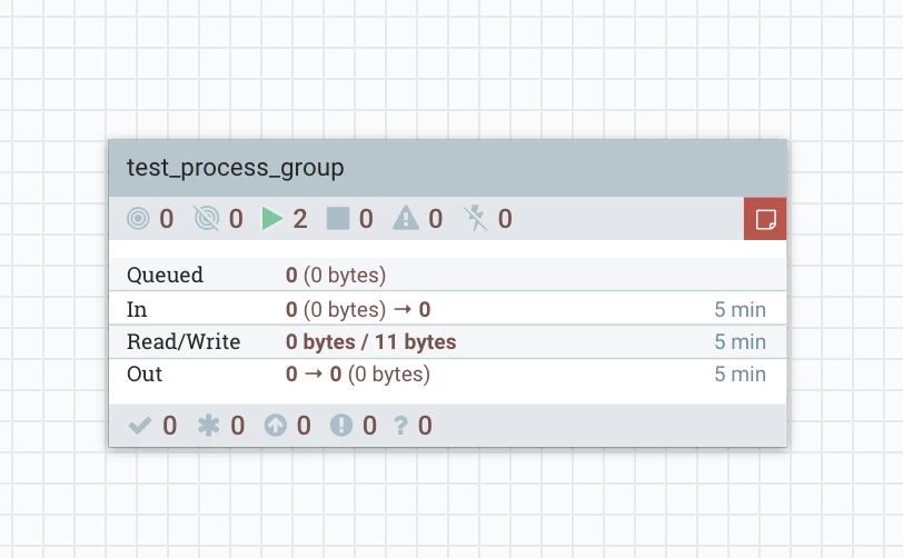

Finally, start the processor flow.
##start process group
canvas.schedule_process_group(new_processor_group.id, True)
To see the newly running flow, go to the canvas. The processor group should be running. Mine has a error and thats due to the file limits I built into my configuration files (no more than 100 files in a directory)

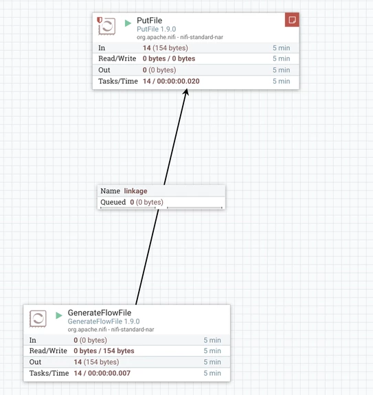

Going into the processor group you should see the two processors we defined:
Given the random nature of putting the processors on the canvas, they may be really spread out so you may need to adjust them on the canvas to see them clearly.
There you have it! A simple flow built by the nipyapi! I hope this demonstrates the powerful capabilities of the nipyapi and how it can be used to create customizable flows...it certainly beats having to write REST calls!
