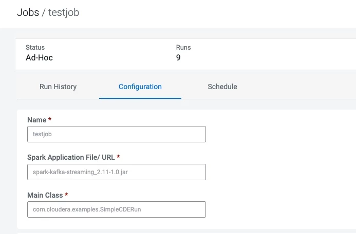

Create a CDE Job
  • Name: Any Name. I called it testjob
  • Spark Application: Jar file provided above
  • Main Class: com.cloudera.examples.SimpleCDERun

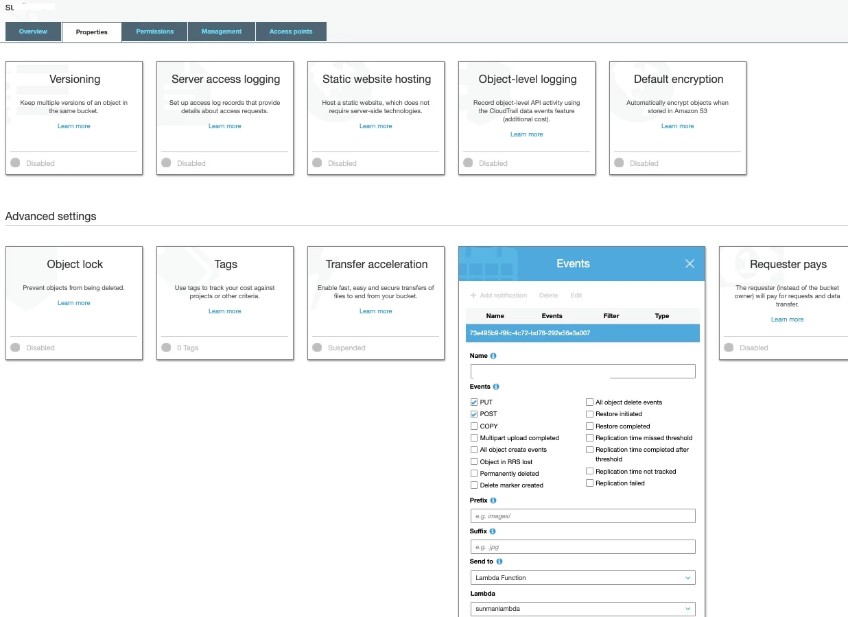

Create an AWS Lambda function to trigger on put/post for s3.  The lambda function code is simple.  It will call CDE for each file posted to s3. Lambda function provided in the artifacts section above.
The following are the s3 properties:

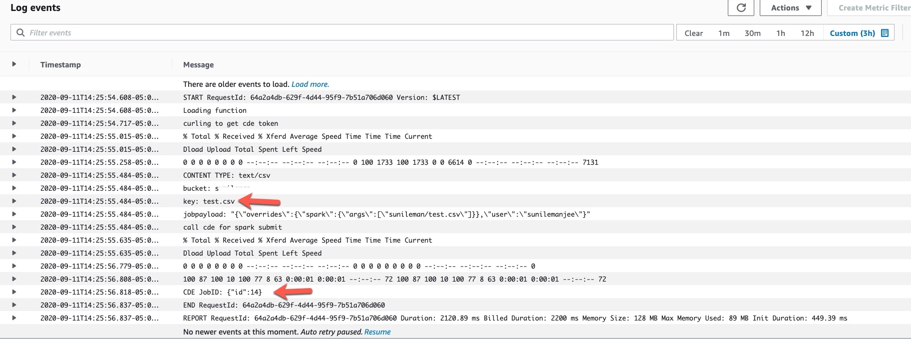

Lambda Log

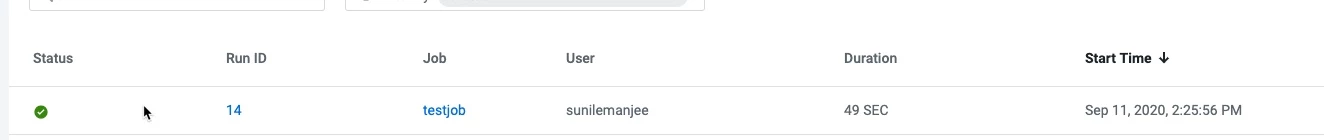

The first arrow shows the file name (test.csv).  The second arrow shows the CDE JobID, which in this case returned the number 14.
In CDE, Job Run ID: 14

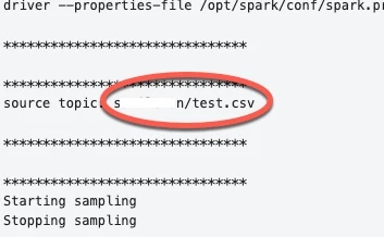

In CDE stdout logs show that the job received the location and name of the file which Lambda was triggered upon.
